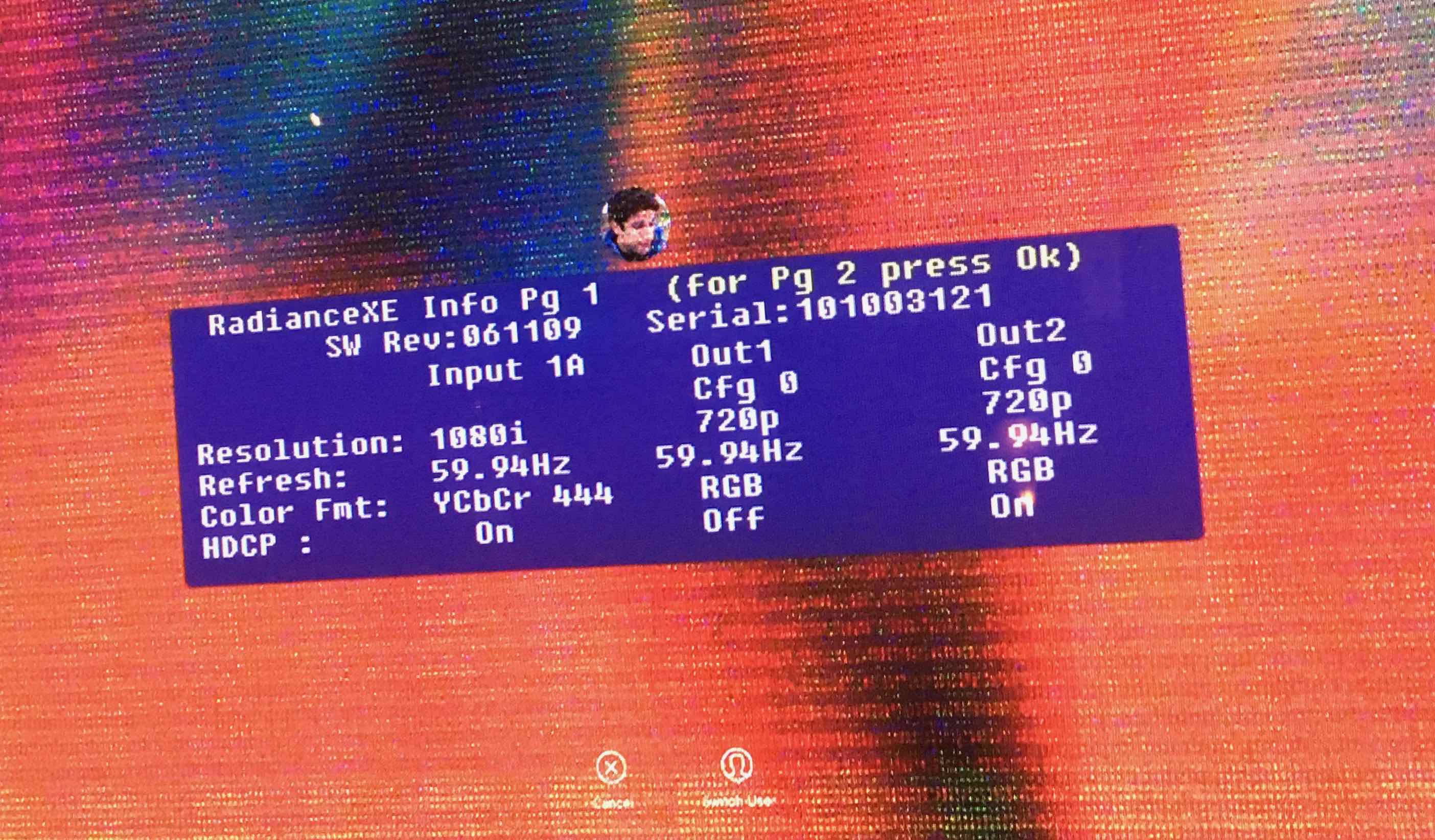

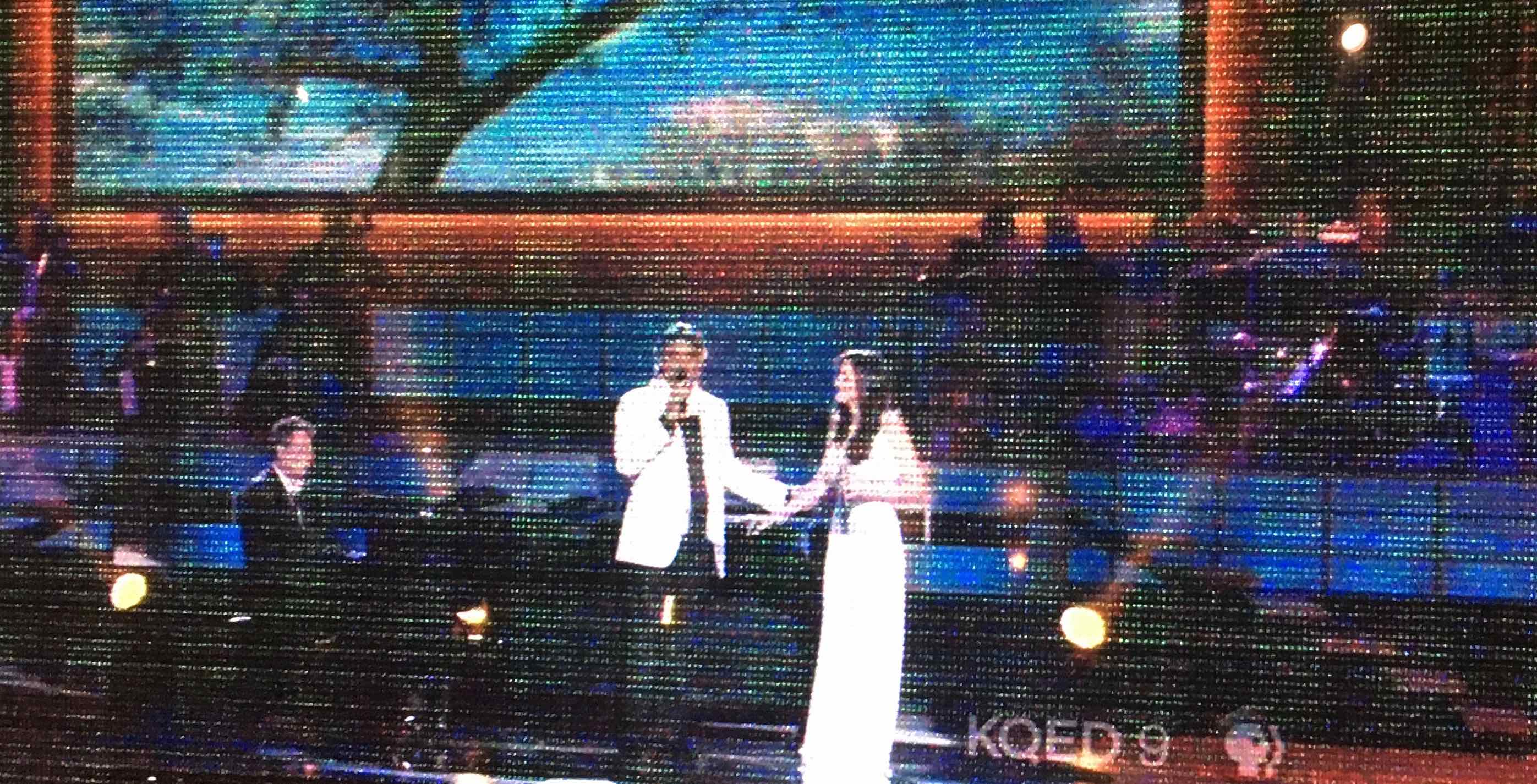

I just bought a used Radiance XE off eBay. I get a picture but it is extremely poor with massive noise. The screen prompts seem fine but the picture is hashed (see photos). I tried multiple input sources and tried both on plasma and Barco 1209. I tried with and with out a cheap stripper.... I ran through all the menus and did not see anything that changed it.
Both are feeds to a plasma. One is from a MacBookPro, the other from DirectV box (This is MBP)
 Filename:  IMG_6519 (1).jpg
 Filesize:  379.77 KB
 Downloaded:  696 Time(s)
Both are feeds to a plasma. One is from a MacBookPro, the other from DirectV box (Directv)
 Filename:  IMG_6518 (2).jpg
 Filesize:  414.77 KB

Do all of the HDMI inputs do this? How about composite/SVideo/component? Do both HDMI outputs do this?
What about resolutions / refresh rates on the input/output side? You tried 1080i/60Hz YCbCr 444 in and 720Hz/60Hz RGB out. Have you tried 1080p/24 in and out directly to your plasma? (I'm assuming the plasma can do 720p). Ie: No scaling at all.
You've already tried a two different displays as the target so that's good. Stick with testing with the plasma and a 'regular' source like a Playstation or something else well understood (and not a PC or something with a billion options available).
The weird dot pattern I have to say doesn't look like anything you should be able to achieve through Radiance settings. If colour spaces are off or depth is wrong, you may get some odd colours or black/white crush or clip, but nothing should introduce a whole pile of dots like that. Weird.

Posted: Sun Dec 03, 2017 11:29 pm    Post subject:
Yes and no. The noise you are seeing reminds me af testing I did on a system here, albeit analog, where the interfearance pattern changed with the scan rate.
If you have a diferent cable or even swap 2 cables around, try your 1080i resolution again and see if the interference pattern changes or is eliminated.

Ok, seller sent me some info on what died.:
--- "game mode verified something happened to the GF9450 board. I will send you a UPS label and refund tomorrow."-----
So it looks like a broken unit. Thanks to all who were kind enough to offer some great suggestions!!

Posted: Mon Dec 04, 2017 2:50 am    Post subject:
Someone with the exact same issue:
http://www.convergent-av.co.uk/forum/index.php?t=msg&th=2570&goto=20341&rid=0&S=d84da51301f5fc93ecbbbc1eeac99556
Note the comment from Jim Peterson (president of Lumagen) at the bottom:
For everyone's reference:
This could be a power supply, but can't tell without testing.
Could be the GF9450 (or its DRAM) gone bad. You can temporarily bypass the GF9450 in your Radiance by pressing MENU 0939. For an interlaced source the image would be half-height since without the GF9450 to deinterlace the image it would be treat as progressive.
Could be something else of course.
P.S. A bit of trivia: The Radiance Pro features much faster switching than previous models as there is no GF9450 deinterlacing chip to have to setup and wait for.

As soon as I saw the images you posted I was going to suggest GAME MODE to test the Gennum chip. There is a known issue where these are failing. It typically only applies to interlaced sources.
Game mode is actually a good fix as long as you don't intend to us the video filter enhancements in the Lumagen as these are disabled. It's also still a good VP if you primarily intend to use it with progressive sources like BD and DVD.
