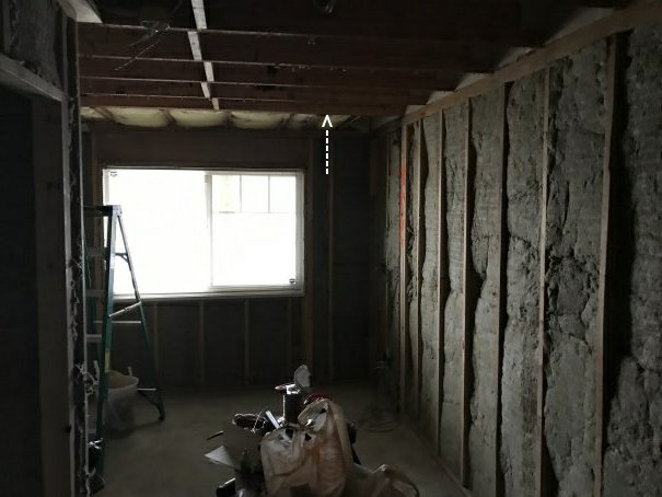

Posted: Mon Mar 20, 2017 3:55 pm    Post subject:
I have to say I am curious as to where you are heading with this.
I see a few issues that might be a problem down the road, if you are interested.
The main thing I question is the framing of the ceiling, which might be a safety issue. Is that
a doubled up joist at the window end of the room? The framing looks a little suspect, so I am asking...

Posted: Mon Mar 20, 2017 4:39 pm    Post subject:
Hi Tedd,
This was the original framing of the house, above that area leads out to a balcony. Here are the original construction drawings for the unit:
The joists become perpendicular at that point and are attached with hangers. I believe this is acceptable, though does create some difficulty with the clips for the hat channel - I will be putting in wood blocking there for the channel clips to attach to at the 24" spacing.
