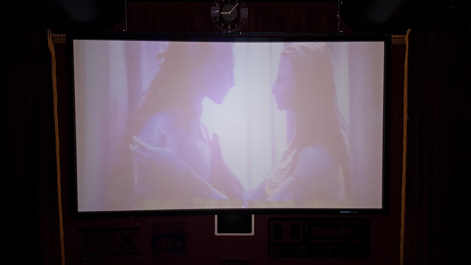

Posting this for a customer. Sold him a G90 and he ordered a Moome card, and told me that his pix via composite was better than the HDMI card. I questioned him, and he sent me a pix, so now I understand. Thumbs Up
He's run a short 6' HDMI cable and tried a longer one, the pix is washed out and pinkish. I know there are Moome commands via the remote, but I know you can also lose the signal. IS the card bad, or can he correct something via the remote?
Two HDMI cables, two sources show similar images.

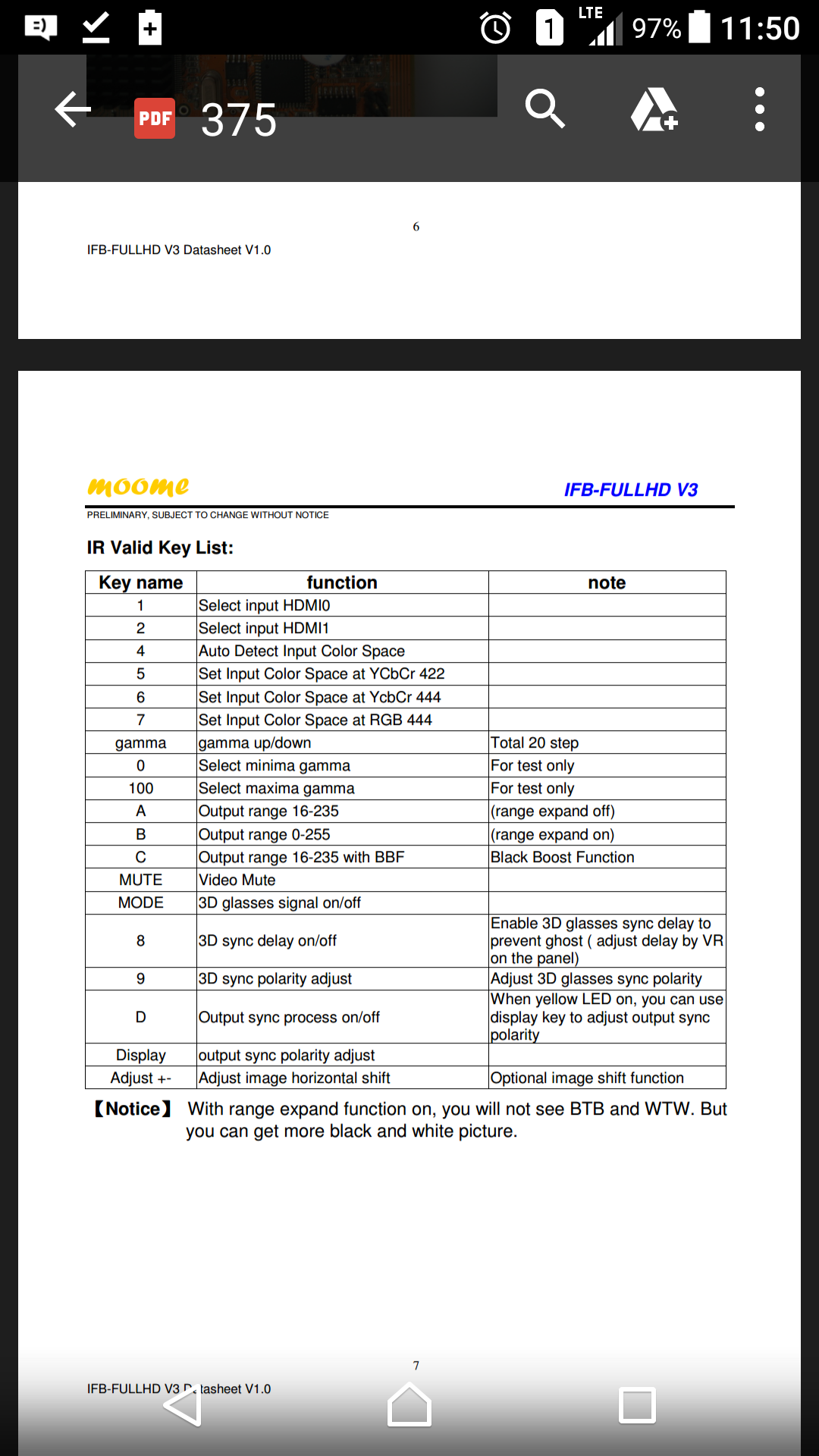

Hit the 5, 6, or 7 button on the Moome remote.
This looks like he's running YCbCr 4:4:4 on the player but the Moome card is set to 4:2:2 instead, or vice versa.
The 5, 6, and 7 buttons set the color space on the Moome card.
You'll get a picture but the colors will be utterly daft if the settings don't match.
Been there, done that, learned it the hard way. With a G90 with Moome card.

I believed the color space setting from the source and Moome card does not match. Try and ask him to select the correct setting of the color space on the Moome by pressing the number button as shown (4 auto etc...) point the Moome remote to the input card please.

Ask him what the model number of his sources are. Maybe we can help him get the correct color space between the two.
Posted: Sun Feb 05, 2017 11:59 pm    Post subject:
It's got to be a mismatch between the output format and the format chosen at the card.
By choosing the incorrect format (4:4:4 or 4:4:2 or whatever) I can also get a pink picture.
Your customer has his source configured incorrectly. I'd bet money on it.
