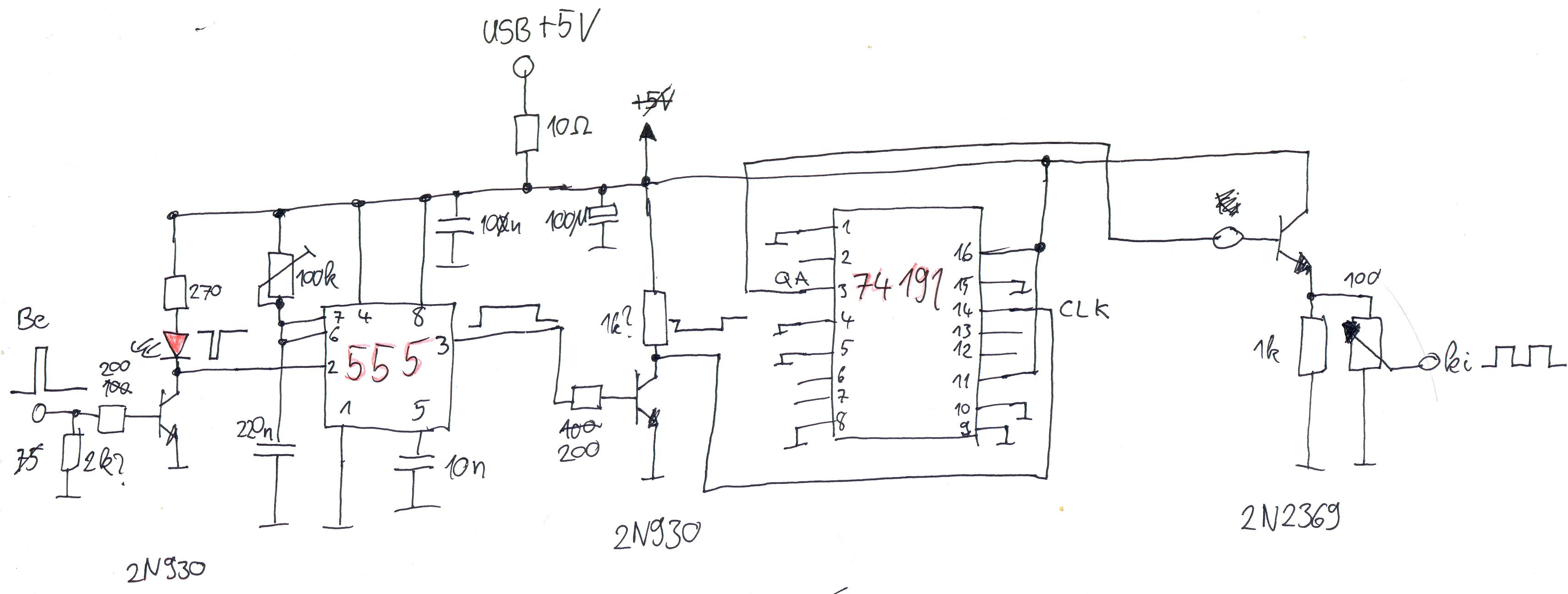

Hi Barclay,
This is what we done in the above mentioned setup as well for the vibrating mirror device.
There was a small script written in AVIsynth, and this was combined with the Stereoscopic player. The recognition of the "frame phase" is not very importand in the first hand because the software can flip the phase with one single button (F7), and still you have 50% chance you catch it on the right frame anyway.
Electronically then only a T flip-flop (or a binary counter) feed by the vertical sync pulse is what you need, modulating the position is a piece of cake, although it is projector dependent how it should be carried out.
In the attachement you can find the schematic of the 1st gen vibrating miroor driver, it even contains a delay, since with digital projectors you may never know how much the displayed picture is shifted from the input sync pule, this is not a problem with CRT though.
