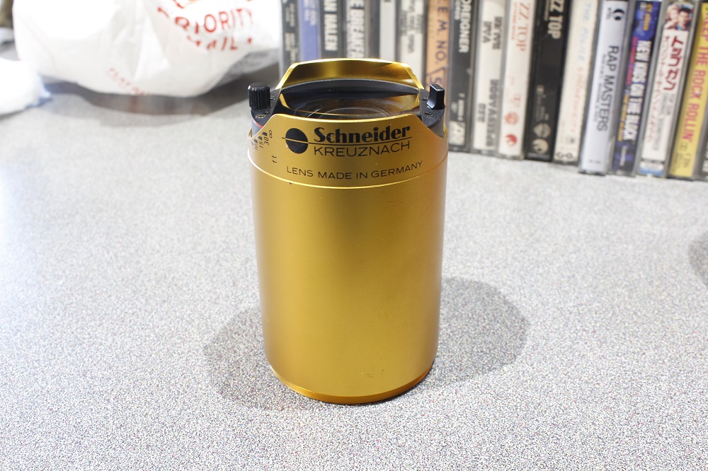

Posted: Thu Sep 29, 2016 5:42 pm    Post subject:
Aaaannnnd here it is!! I looked at my widescreen LCD through it and :O super wide. Time to test this baby out!!!
Anamorphic Lens

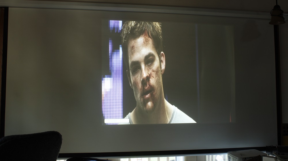

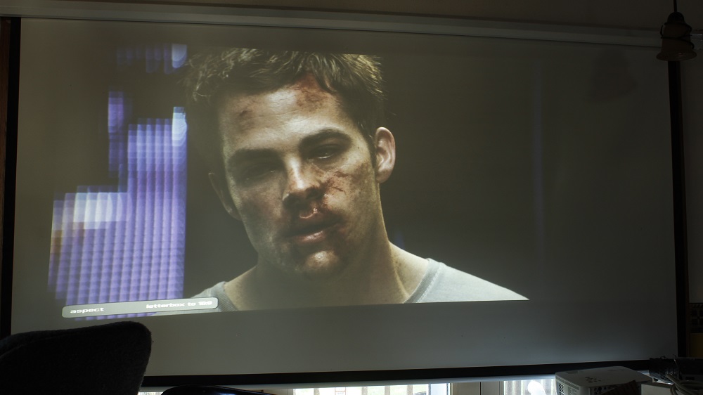

Posted: Thu Sep 29, 2016 6:33 pm    Post subject:
Ok, did some playing around with it so far, and crabb was right, on a 16:9 PJ the image stretches out incredibly wide, BUT, between the PJ and the PC, you can actually make a 3.56:1 screen and AR of the movie with this lens. The downside (and this happens on both 4:3 and 16:9 PJs) is the lens pincushions the image, so it really isn't suitable for a digital PJ. At least not without modifying it with some lens elements to fit into the PJ being used that is (which is far beyond what I want to do).
Anyway, I'm sure some want to see pics anyway. So I've taken 2 photos of "Star Trek 2009" with the lens in place and without it to show how squeezed the image is.
I'm using a ProjectionDesign F20 SX+ SXGA+ machine to do this, and honestly, if the whole image fit through the lens and didn't pincushion, no one would be able to tell if it was a 1080p machine or not.
I'm sold on anamorphic lens use for a digital after just playing with this one for a half hour, its simply amazing to witness in person!!
Anyway, Pics: (Sorry for the bad quality)
Edit: The image DOES fit through the lens, I simply forgot to zoom out Razz Still pincushions unfortunately...
Squeezed image without anamorphic Lens

Anamorphic Lens in place

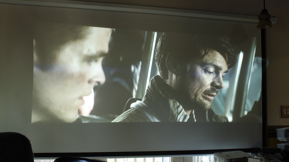

Posted: Thu Sep 29, 2016 6:41 pm    Post subject:
Here's another one with the zoom properly zoomed out (yes the PJ isn't centered on the screen, I know Razz ) Its a very crispy lens, and you're seeing all 1400x1050 pixels being used by the movie Very Happy
