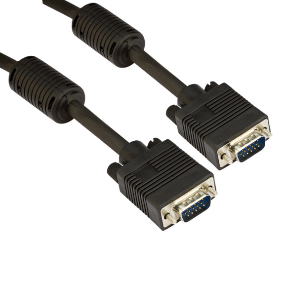

Does your monitor have a removable cable? Does your current cable have RF chokes on it? ( the round clamped on things 3-4 inches from the ends)

By chokes you mean the things that screw into the VGA terminals? Yes. The cable detaches but all cables exhibit this behavior, even the RGBHV (yes - the monitor has an RGBHV input - it can sync on green too).

It's the round things about 3 inches from the plug on the cable.

Yes it has them.

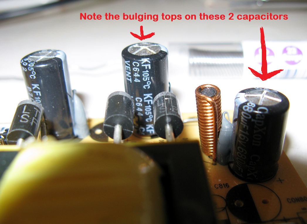

Any obvious things to look for on the video board itself? When capacitors age, do they start to bulge? Or will I need some test equipment? If so - what?
Posted: Wed Aug 02, 2017 4:35 pm    Post subject:
Capacitors start to bulge on top.
You may try getting some Caigs DeOxit cleaner and cleaning all the contacts in your monitor too.
