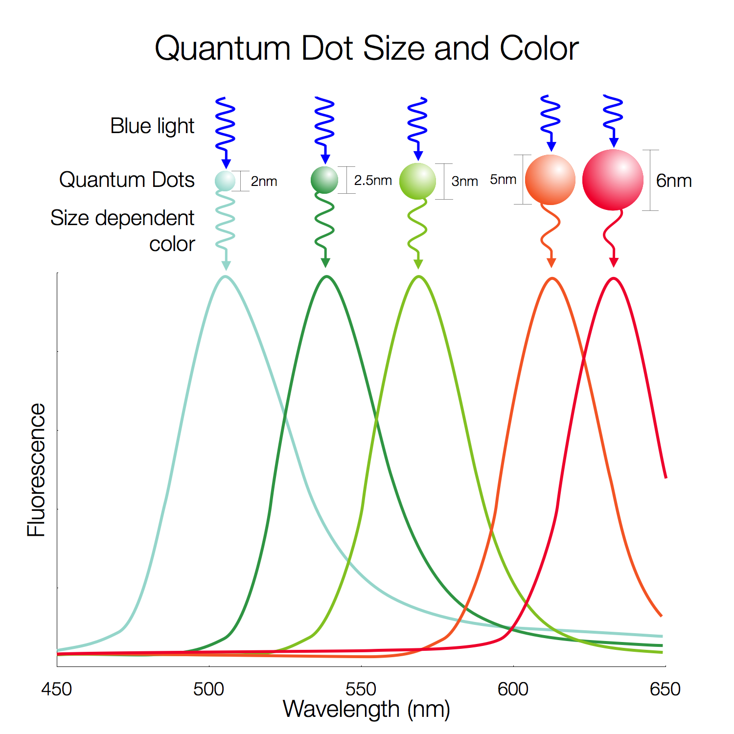

OK, I got off the turnip truck and found the company that is behind Samsung's marketed QD. It is Nanosys Inc. and in watching a video (on AVS) and looking at this diagram it seems the technology is more akin to plasma than anything else.
It just takes a high energy source and re-emits it at a different wavelength based on the size of the dot. That seems like how plasma was doing it.

I guess my point is that Quantum Dot LCD from Samsung is still LCD, which means they still lack good control over the emissiveness of the back panel light. This is not a true Of/Off technology that can work on the [sub-]pixel level like OLED.
