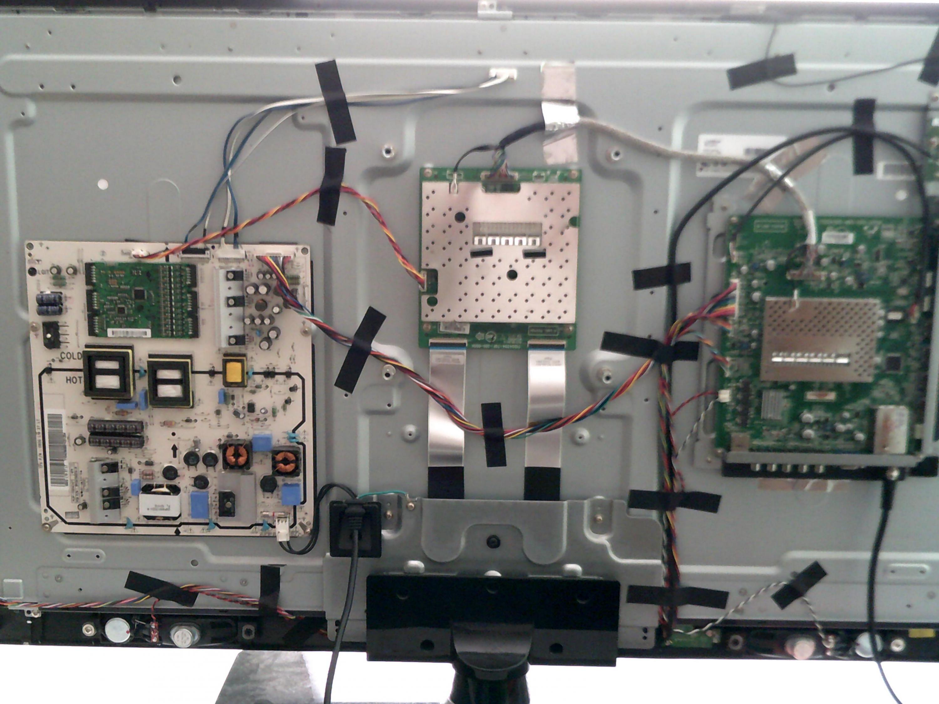

Posted: Sun Apr 17, 2016 11:52 pm    Post subject:
Can you post a picture of all the circuit boards inside the set?

Posted: Mon Apr 18, 2016 9:26 pm    Post subject:
Here are some pics thanks

Posted: Mon Apr 18, 2016 10:07 pm    Post subject:
Vizios are known for bad motherboards. Note that even if you find a used motherboard for cheaper, it will most likely fail the same way again. Do a search on this forum for exactly that story on another Vizio. Guy replaced the power supply for $100, that wasn't it. Finally found a CPU/motherboard for $130. That fixed it, and 6 weeks later it died again, same problem.
Throw it away, it's not worth doing.

If you decide to fix it, try the main board on the right side in your picture first provided you can test the power supply to see if the voltages from the power supply are OK
