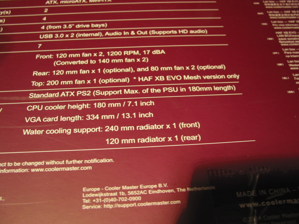

If you buy a GTX480, remember it is a very long card and does not fit into normal midi tower PC cases.
Mine is 27cm=10.63" without the mounting metal part.

Thanks for the warning.
I just got my new case. It's the Cooler Master HAF XB EVO. I'm looking at the box right now it says max VGA card length 334mm/13.1 inches so I should be OK.
