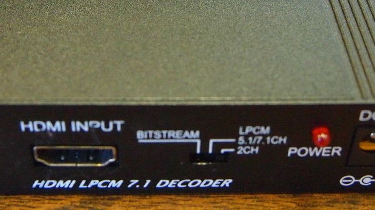

One other possibility I'm exploring is a breakout box. I used one on vacation to run:
PS3===>HDMI----BreakoutBox---7.1Analog===HarmanKardonReceiver_w_7.1AnalogInputs
You use bitstream out to the breakout box then 7.1 Analog out via 3.5mm jacks.
 Filesize:  48.89 KB
