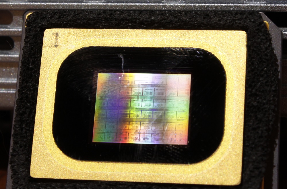

Posted: Mon Mar 21, 2016 3:10 pm    Post subject:
It's time to reveal the answer to how long a pro 1 chip DLP PJ can last. Thank you to the 11 of you who voted, interesting results Smile
Those of you who voted 25,000+ hours were correct. I have had several liquid cooled Panasonic 1 chip DLP sets come in with hour counts of over 26,000+ hours and zero operational issues, and thats pretty good considering some of them never get filter changes and have generic bulbs thrown in them.
Now the set I have here that made me start this poll has a whopping 65,615 hours of usage. Thats just under 7.5 years of continuous usage. The set itself is only 8 years old! So far this is the highest hour projector I have ever seen in person, or anywhere else, and it was still operating. All the fans are worn out, they are louder than hell, the light path is literally cooked (the plastics have almost completely deteriorated where the lamps install) the chassis plastics are also cracking and nicely baked, and to top it off: the DMD chip itself had 3 stuck pixels and what you see in the photo below:
So thats the answer Smile
Edit: Yes, the DMD chip itself has actual BURN in. the micro mirrors still operate as they should, but the image being projected from this machine was on it so long it actually burned the mirrors!

Posted: Sun Apr 10, 2016 10:43 pm    Post subject:
Oh, incidentally, that "screen burn" as you describe it may not be what you think it is.
I have some DMDs out of a projector that had a power supply failure (a big 3 chipper)
that took out the DMD formatter power so quickly that the DMDs just stuck in their last
displayed frame. Which in this case was a checkerboard pattern.
They will hold that pattern FOREVER, or until reinstalled and put back into service.
Odds are that the DMD shown above is in the same state. It may have some worn out mirrors
and flaky pixes because of it, but I'll bet it'll reset if put back into a working projector.
Permanent image retention on interruption of signals IS one of the characteristics of a DMD.

Posted: Wed Sep 28, 2016 2:47 pm    Post subject:
A bit late to the reply here I might be, but what the hell. The DMD chip was actually permanantly stuck that way, it displayed what you saw on the DMD in the photo, on screen, it was quite horrible to view and totally not usable. I know what you're talking about though, when I pull DMDs out of junk PJs they do leave the last image they had on the DMD, though unlike most DMDs, the 65k hour one did not reset itself and just remained the way you see it.
Still, that many hours, I think it would be time for an upgrade anyway Smile
