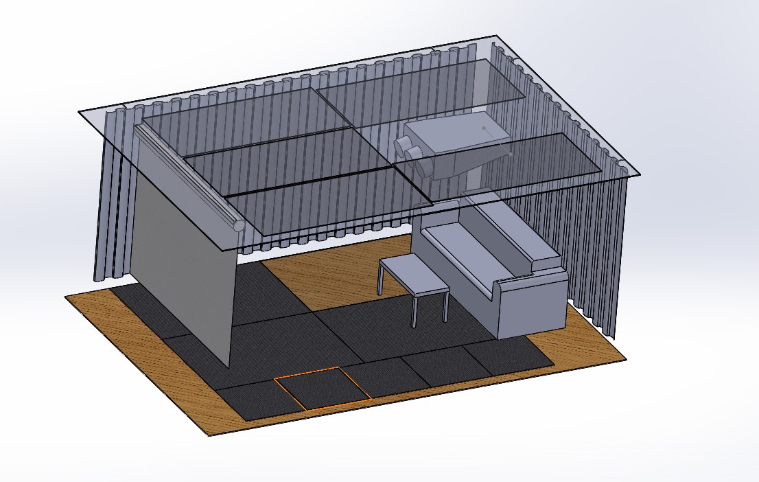

I'm in the process of moving to a new apartment closer to work and this will give me a golden opportunity to make a good home theater from scratch. My original plan was black shagpile carpets, thick heavy black stage curtains for all walls and not wanting to paint the ceiling, use black tiles for downlight installation and to black out the ceiling from light scatter. My friend/interior decorator said something about "eternal single" so there will be some compromises.
I'm still learning solidworks, but here is a 3D sketch I made.
Oh, and although I do have a job and make money, I might be the least well-paid here on the forum where people can spend ridiculous amount of money on the latest projector, permanent installs and gigantic home theaters, which I can't. Need money for the rest of the furniture as well.
The living room is 3.63 x 5.42 meter. With the screen down, it will be tight.

Melifluonze wrote:
Posted: Tue Sep 08, 2015 12:31 pm    Post subject: Re: Home theather / living room from cratch
winny wrote:
...thick heavy black stage curtains for all walls ...
That would probably overdampen the room. Typical HT acoustics has you being absorptive below ear level and reflective above (while seated). Some will dampen the entire screen wall too.

Posted: Tue Sep 08, 2015 12:52 pm    Post subject: Re: Home theather / living room from cratch
How come?
Yes, all four walls will have curtains.

Posted: Tue Sep 08, 2015 1:03 pm    Post subject: Re: Home theather / living room from cratch
winny wrote:
How come?
What part are you asking about? Why that would probably overdampen the room? Why typical HT acoustics are absorptive below ear level and reflective above (while seated)? Or why some will dampen the entire screen wall as well?
The why's and how's for all of these are are pretty in-depth discussions to get into - you can start reading a bit over at the AVS Forum "Dedicated Theater Design & Construction" section here: http://www.avsforum.com/forum/19-dedicated-theater-design-construction/
Or take a look at this "Practical Guide to Home Theater Acoustics" which pretty much summarizes everything into an easier to read format: http://www.curtpalme.com/PracticalHomeTheaterAcoustics.shtm
That's a common approach that many people think they should take, but tends to completely overdampen a room. You want some reflection, otherwise the room sounds overly dead. If you take a look around our forum here at pictures people have posted, many will build panels and only partially cover the walls, like this:

Posted: Tue Sep 08, 2015 1:18 pm    Post subject: Re: Home theather / living room from cratch
Why you wouldn't want dead acoustics? When I'm in a cinema, it sounds far from re-vibrant (is that a word?), although not as dead as an acoustic dead room. I have had the opportunity to visit one 10*10*10 meter which was suspended from the building too and it was uncanny silent to the extent your own heartbeat became too loud to be comfortable.
I'll try to plow though your links. With curtains it will be easy to change them if needed, but making the walls black should lower the light scatter even if they are too thin to dampen any sounds.

Posted: Tue Sep 08, 2015 2:32 pm    Post subject: Re: Home theather / living room from cratch
Because it doesn't sound good. There is zero liveliness to it, no ambiance. Not sure how well to explain it.

Posted: Tue Sep 08, 2015 2:53 pm    Post subject:
Interesting. I come from the live sound world where you never have too little acoustics (on stage in particular) so more damping = better.
Would it be a better compromise with thin black cloth on the walls, shagpile floor and hard black panels under the ceiling?
With three curtain racks I would still have the option to fabricate acoustic panels to hang behind the fabric if needed.

Posted: Tue Sep 08, 2015 6:13 pm    Post subject:
A thin black cloth stretched on the wall won't do anything.
Without knowing what you mean exactly about the other things (ie: Their acoustic properties), I can't really comment.

Posted: Fri Sep 11, 2015 6:45 am    Post subject:
How about damping the ceiling and floor with acoustic panels and thick carpet?
