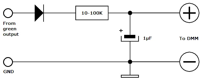

That will be quite difficult, but I will try to find some alternative. Maybe a small additional circuit that will produce a defined voltage (measurable with a conventional multimeter) when a specific input signal (picture content and resolution) is used. Let me work on that...

It should be a solution which works with different types and qualities of multimeters. Otherwise there are too many factors that could deliver erraneous results. A capacitor connected directly to the signal would simply kill it off as the capacitor represents something like a short for high frequency signals. There's even a chance that it could damage the corresponding video amplifier opamp.
I will try with a resistor (something in the 10-100K range) and a diode that charges a small capacitor (around 1µF) so that I get a voltage without significantly influencing the signal. The diode will prevent any of the capacitor's charge to flow back onto the signal although its forward voltage drop will reduce the final voltage level (maybe putting several in parallel will work better). But it's not necessary to produce exactly 0.7V at its output. Any other reproducable result which represents a 0.7V pp video level will be sufficient...

With a full white test pattern there isn't much high frequency signal, think of it as a ~99% duty square wave, which is smoothed by the capacitor. The video output should have 75 Ohm output impedance, that ensures the output even can be shorted...
For the series diode a schottky type could be a good choice, that still have 0.3V loss or so, which is temperature dependant, and even depend on the actual device somewhat. Without terminating the output the signal is twice as big, so there is some voltage to loose, but the reflections should be considered as a residual effect.

Possible. But we don't know which opamps Moome used on his cards (markings removed/replaced). So we don't know about their maximum allowed output current. 0.7V at 75 ohms result in 9.3mA. A CLC449 can deliver up to 80mA. Maybe the ones Moome used can deliver less. And if the output got "shorted" due to a large cap, there wouldn't be anything left for measuerement.
Yes. I had this type of test picture in mind as it produces the maximum output voltage over time.
I think that this can be neglected as the signal is tapped only (therefore I would like to use a resistor with a higher value). It stays connected to the VIM's 2nd RGB input and is terminated with 75 ohms there...

One suggestion though would be to get the green signal off the multipin connector rather than the resistor. Those members who don't normally do surface mount soldering will have an easier time adding the test lead and have less chance of damaging the board. You can connect to the pin on the underside of the board if it's inaccessible from the top. This will also protect again board solder fatigue.
Also, the easiest test pattern to use is a 100 IRE window. The 100 IRE window shows full 100 IRE (0.7 volt peak white) and full 0 IRE black. The difference on the oscilloscope between black and white should be set to 0.7 volts.
Thanks!
I will add this when I add the DMM measurement procedure...
