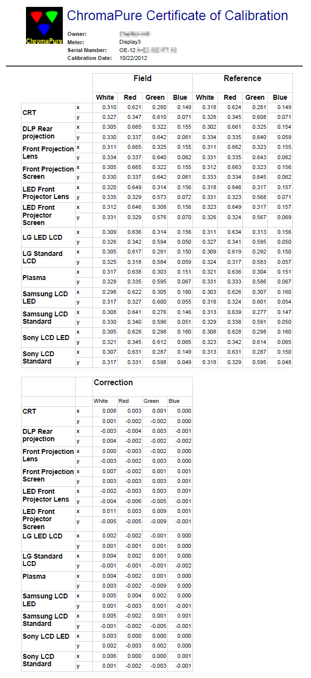

Received my Display 3 Pro kit, with the Certificate of Calibration.
Are these figures to be plugged in to the correction module?
I tried, and my readings are off.
Obviously I am doing something wrong. Do you have a procedure for using the Calibration Corrections?
Thanks.
Posted: Mon May 18, 2015 7:36 pm    Post subject:
The offsets are built right into your ChromaPure meter licence. There is no need to enter anything. The Certificate of Calibration simply shows you how far off the original stock X-Rite i1Display Pro meter was (shown separately for the 10+ different display types for which ChromaPure compensates). In theory you could take these values and use them in other software too.
The certificate looks like this:

Ah. So the corrections are baked into the software via my license, correct?
TomHuffman
Joined: 01 Jun 2010
Posts: 76
Location: Springfield, MO
Posted: Tue May 19, 2015 2:47 am    Post subject:
Yes. If you go back and read the e-mail that was sent to you that contained the download and installation instructions, it says "The PRO corrections are stored in the license file and documented in the attached report. No action is required to enable them."
