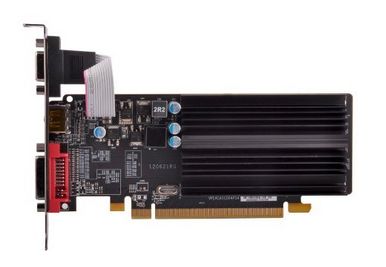

Just updated a Dell E510 with an ATi 5450 1GB video card and Ubuntu 14.04 LTS. 32Bit
(3Ghz HT, 3GB RAM)
Occasionally when waking from standby, the video will flash, screen will come back, go out, come back etc...
Do I have a bad video card or is this Linux problem. After a power down/reboot it's been fine for hours.
XFX AMD Radeon HD 5450 1GB GDDR3 VGA/DVI/HDMI Low-Profile PCI-Express Graphics Card HD545XZQH2;HD-545X-ZQH2

EDIT: added card model

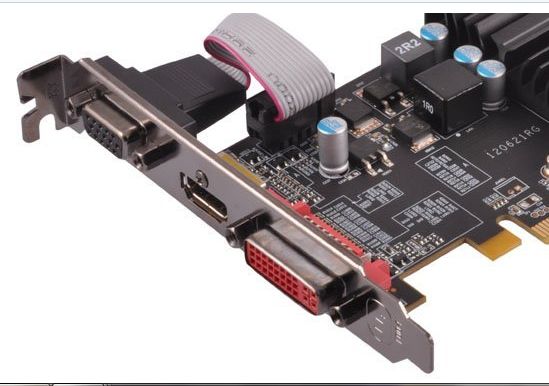

Posted: Sat May 02, 2015 3:50 pm    Post subject:
I kept the card. I got a DVI-I to VGA adaptor. Stopped using the top VGA port and used the DVI port.
Wakes up and the picture doesn't flash.
Weird! But that's my work around.
Also tried to do the enter Kodi/console and exit but when the flashing starts is locks the system up.
