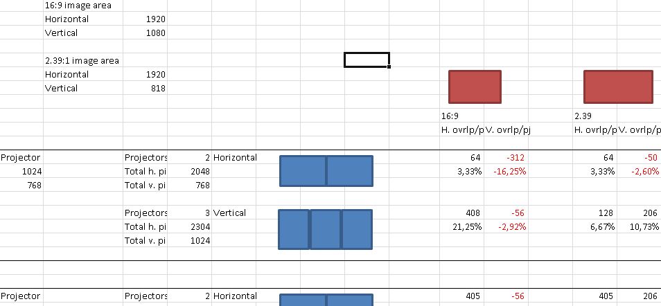

Looked around for a cheap 1024x768 projector but very few have any digital input and lamp run cost would be high with two or three projectors running.
Did a quick and dirty excel-hack to calculate the blend-zone for various configurations and resolutions.
 Filesize:  52.23 KB
 Viewed:  24701 Time(s)
blend.xls
Excel-hack
 Filename:  blend.xls
 Filesize:  94.5 KB
 Downloaded:  826 Time(s)
