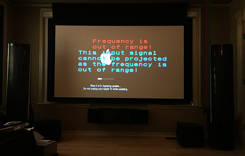

When I connect to the Apple TV it displays an error message that says..
Frequency is out of range!
This input signal cannot be projected as the frequency is out of range!
Any thoughts??

Here is a shot of the message...

5. The apple TV is probably seeing the edid in the Moome ( the chip with the resolution/refresh info) and setting itself to 1080p which is too much for the projector.
See if you can switch the Apple to 720P instead
And try the bluray at 1080i

Please make sure :
1. Set input B as RGB input mode
2. the resolution of bluray player and AppleTV are set to 720P 60Hz or 1080i 60HZ, D50 can not handle 1080P due to bandwidth limit.
thanks
Jeremy's exactly right: Your projector doesn't support 1080p or 24Hz (no CRT projector supports 24Hz). You need to set your source to a resolution/refresh rate supported by the projector.

Thanks for the help. I changed the output frequency in both Apple TV and the DVD player. That solved it. Thank you very much for the help.
