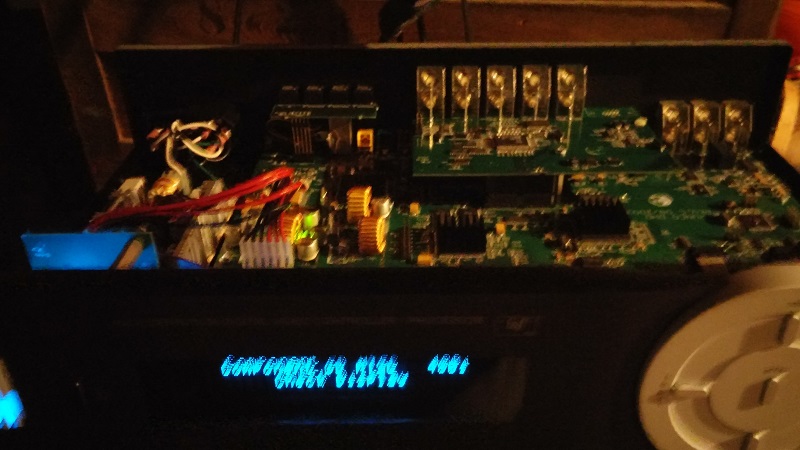

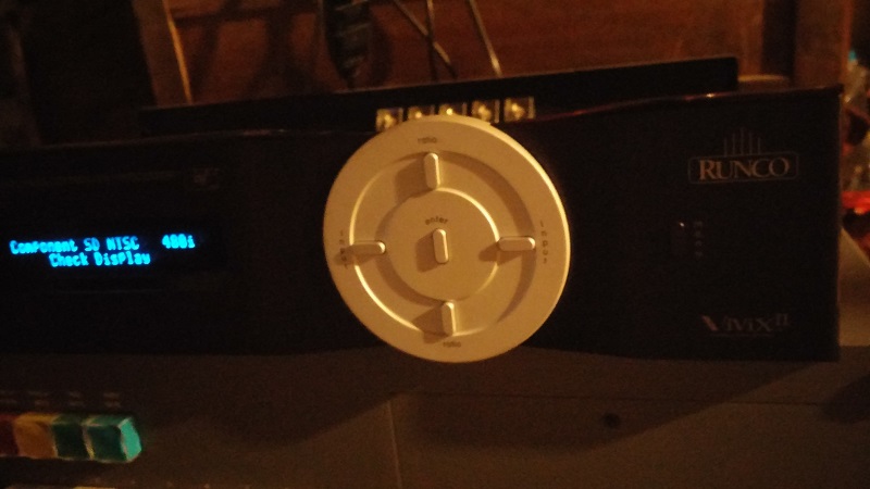

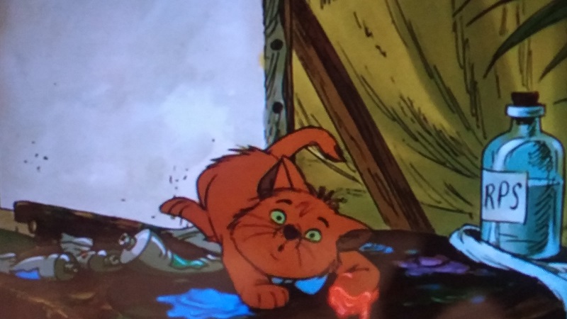

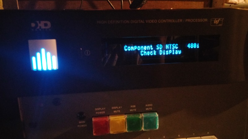

OK, so I picked up a Vivix II processor (DHD version) for converting sources like LaserDisc etc to 720P. I wanted a Vivix II based on reviews specifically related to older content performance.
After purchase, I realized this was one for a plasma panel.
With trickery in the service menu, I can eventually get it to generate a picture and take a source, but it takes about 5 minutes or so worth of tinkering and flipping through output settings.
I attempted to make some changes to the board based on estimation, but lost output completely, and had to revert my changes.
There has to be someone out there who knows how to modify this further, as I have found historical sales that show units that have been modified to work stand alone, but no details can be turned up.
This is definitely a great scaler for old mediums! I'd just like a little more reliability in getting it to display a picture.

The manual calls for the TV to be placed in the DVI out plug, and connected via the internal RS232 COM port.
My guess is that there is a COM handshake that happens before allowing output to happen.
Tom foolery in the output menu and display settings eventually gets the unit to give up blocking the output.
As for resolutions, there are tons in the service menu, each work fine (after the unit "unlocks")

Well, everything works just fine once you get the output to work.
The problem is, even if the unit is turned off, you have to go into the service menu and adjust the RGB output type a few times, then turn it on and off a couple of times then change around the output from DVI to RGB.
Sometimes you have to flip the power on and off, and the chances of you getting an output increases with a factory reset.
Getting video output isn't exactly easy, but it eventually works.-
Runco made several different spec units. 1. Stand alone, 2. Plasma, 3. Projector.
The chassis and boards are identical.
The service menu is accessed with hitting ENTER, LEFT, LEFT, RIGHT RIGHT, ENTER, when you are on the first blank space.
There's a second blank space, and a third blank space that I can get to appear sometimes, maybe there is a factory spec unit there somehow...
Now I'm just speculating...
I haven't made any further hardware changes since I re-soldered a few things I removed.
I thought about calling runco, but I don't even know if they would give 5 cents to the thought of the issue.

After the video output is unlocked, then yes, and everything works well.
The outputs don't work on turn on because it's expecting a runco plasma panel to talk back to it, and were designed to only operate with their equipment, at least that's really only all I can find.
