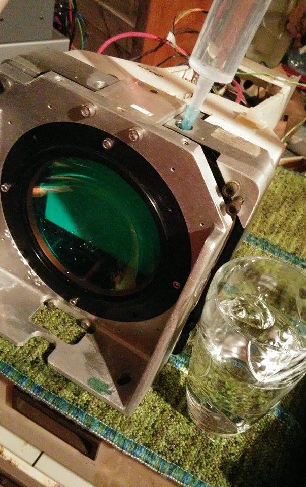

So, IceClear AF arrived last night, and I replaced the distilled water I was using for testing in the 9500LC.
The differences are significantly noticeable between distilled water and the IceClear AF. I have no reference for regular CRT fluid, as it was all bad, and the projector was not even slightly installed correctly before it was removed.
The total cost for 1 gallon was $20 shipped, and the installation process was no hassle. Regardless, I feel this is evaluation worthy. I've got razor thin convergence lines where they used to be fluffy caterpillars even under the best of circumstances. I'm going to say this is probably how the ethylene glycol based fluids work however, as the refractive index of the main chemicals are pretty much the same. There may be visual gains between the two, but they are probably miniscule.
This is more about cost effectiveness, and a modern day eco friendly chemical alternative evaluation.

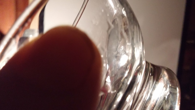

I have started this thread to track the performance of IceClear AF, as I have not been able to find any definitive evaluations for use in our projectors. I will be taking pictures of tubes and quantities of the installed fluid at random intervals, and have 2 control containers set out as well, to test color stability. One container has 2 original screws used in the LC chambers. The other does not, as all the major screws have been converted to stainless steel.
IceClear AF is appealing over traditional EG+Glycerine cut compositions for the reasons that DP+G isn't as destructive and reactive with aluminum vs EG, and includes a multi-metal corrosion inhibitor. If this material stays color stable, and clarity stable, this could pan out to be a worthwhile substitute, and at a total lower installation cost.
No image pictures are currently available, as my phone was flat by the time setup and testing began, but they will be added.
