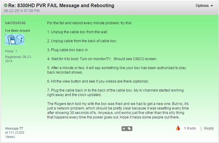

Rogers pushed an update that killed these boxes, caused a re-boot loop. Here's a possible work around:
http://communityforums.rogers.com/t5/forums/forumtopicpage/board-id/PVR_settop_boxes_remotes/thread-id/15031/page/8

Hmmm still won't authorize. I bet the F#$%D up my account when I last spoke to them.
Call tomorrow.
