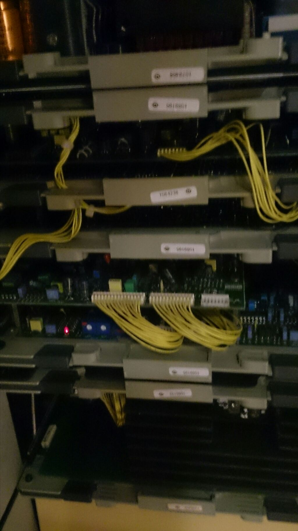

It worked last time I tured it on one year ago but now the image (all tubes) flashes on-off every second. Menues are shown correct when the image is on.
Board 1089195 have a red LED flashing at the same rate. All G2-LEDs appear green.
I'll try to post a video and some photos if it helps.

I have the service manual for 1209s and the red LED D40 on the Sync+Vertical deflection board is comming from the coincidence detector.
What does this mean?

I have fiddled around some more today with this and depending on resolution, the flashing changes frequently slightly and goes away slowly as the projector heats up after a few minutes.
Any clues?

Does the internal test pattern flash as well, or is it solid? What does the internal test pattern do if you disconnect the input completely?

Never seen that before, but it seems to only be the green tube doing it?
Try disconnecting the green CRT socket and HV lead, and see if the R and B tubes are OK. If so, try swapping CRT sockets/video amps between tubes. If it stays with the green tube, it could be an issue on the G2 board, one of the two video switching/quad decoder boards, or worst case, the tube.

OK, then disconnect the tubes one at a time, the CRT socket and the HV lead.
I have seen this a couple of times in a planetarium, but when in the G2 setup mode, which the 1209 doesn't have. The set would flash, and it was due to low emission of the tubes, that sent the G2 setup into spasms. I have not seen this in a 1209.

All I can tell you is that it appears to be video related, and not HV related.

So what does D40/coincidence detector mean since it indicates this along with the flashes?
Melifluonze wrote:
Posted: Mon Mar 09, 2015 1:45 pm    Post subject:
It means it is losing sync, but that doesn't explain the flashing.
