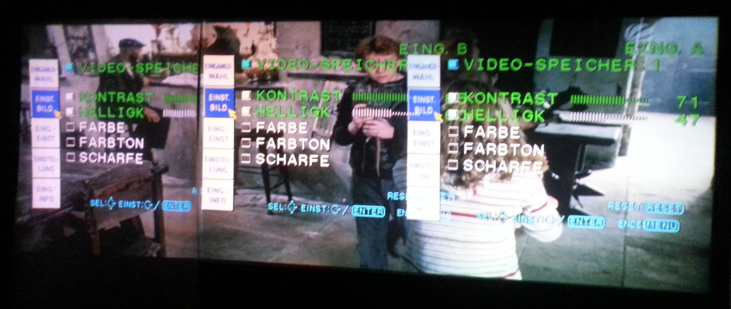

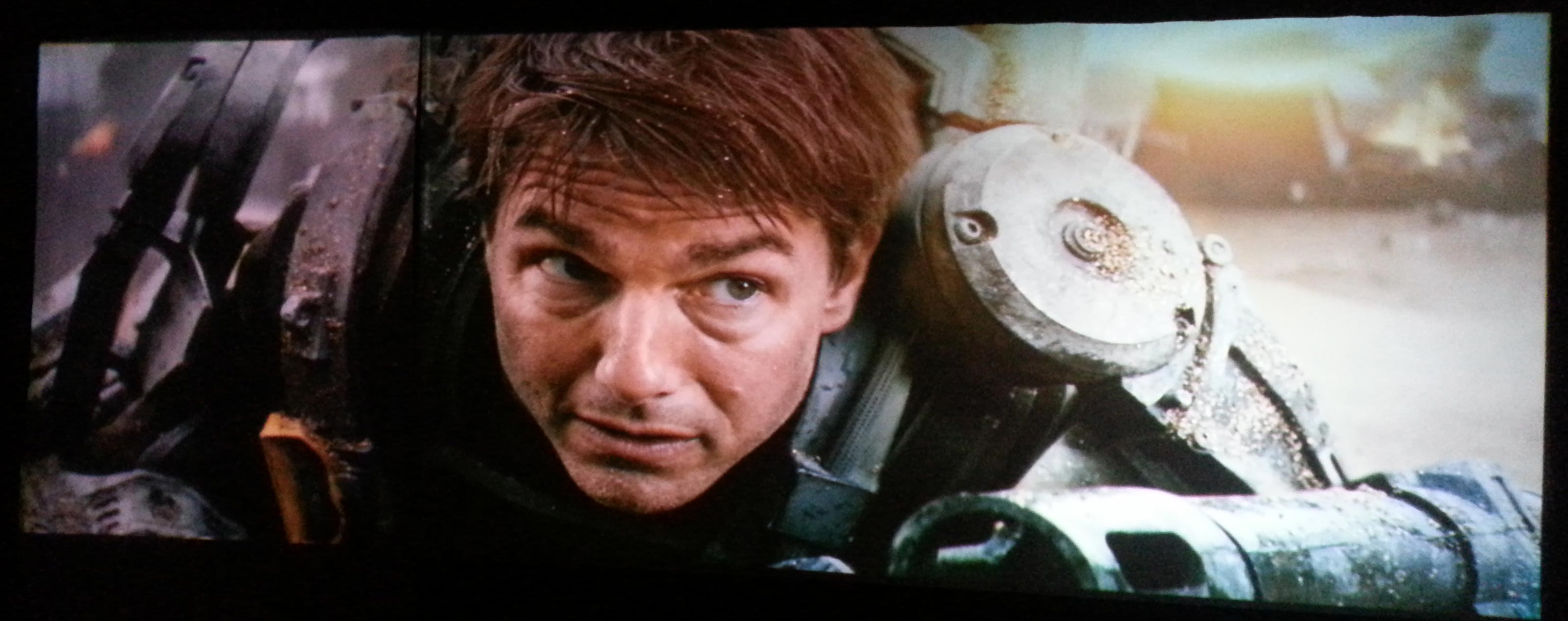

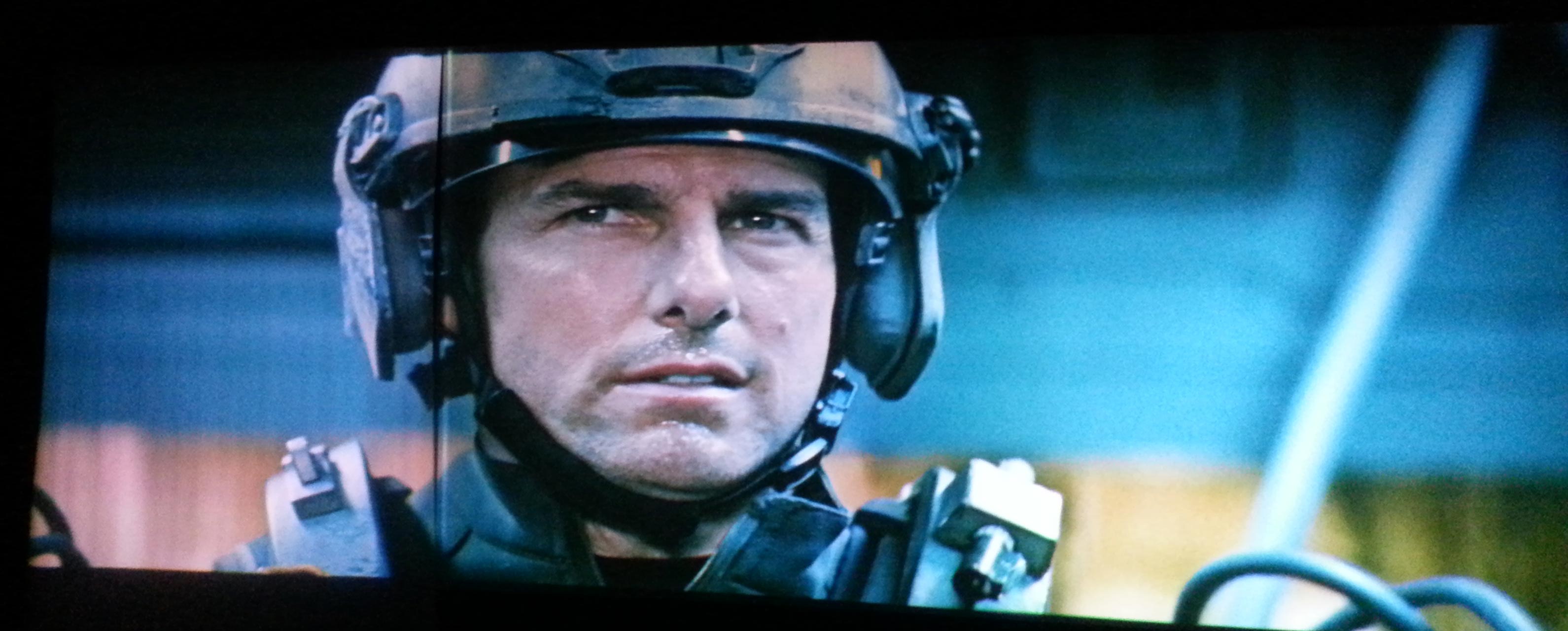

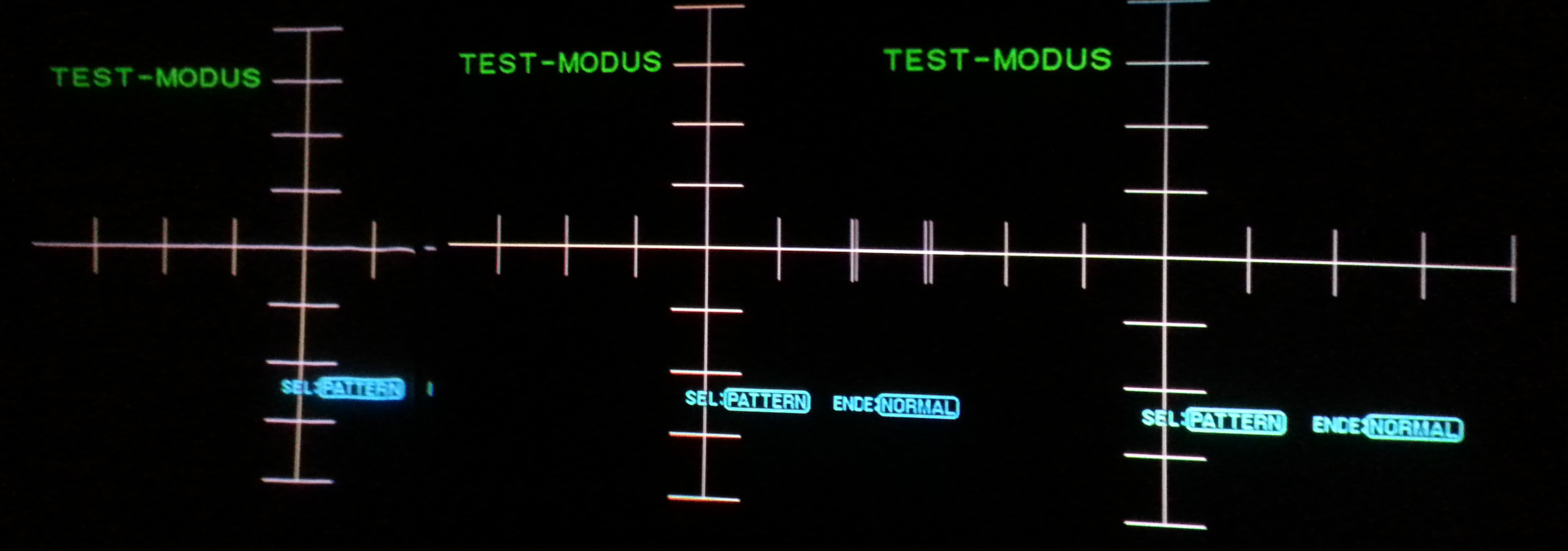

Posted: Mon Feb 09, 2015 4:34 pm    Post subject:
sorry, I didn't mean stack, I mean blend with three Sony G70.
Here some pictures from my Samsung S3, not realy good but for a first impression.
regards
didaschi

Posted: Mon Feb 09, 2015 4:43 pm    Post subject:
Hello,
all G70 stand on the ground, so it is not so good to rotate them.
For blending I use Win7, Sapphire 6450 flex card with Eyefinity for horiz. span of three displays and Mediaplayer classic for the shading.
Regards

Posted: Mon Feb 09, 2015 4:52 pm    Post subject:
soft egde blend and I have been using the software from curt palme
https://www.curtpalme.com/forum_archived/viewtopic.php@t=18404.html
from user antorsae for years.
Up to now with two Sony G70.
