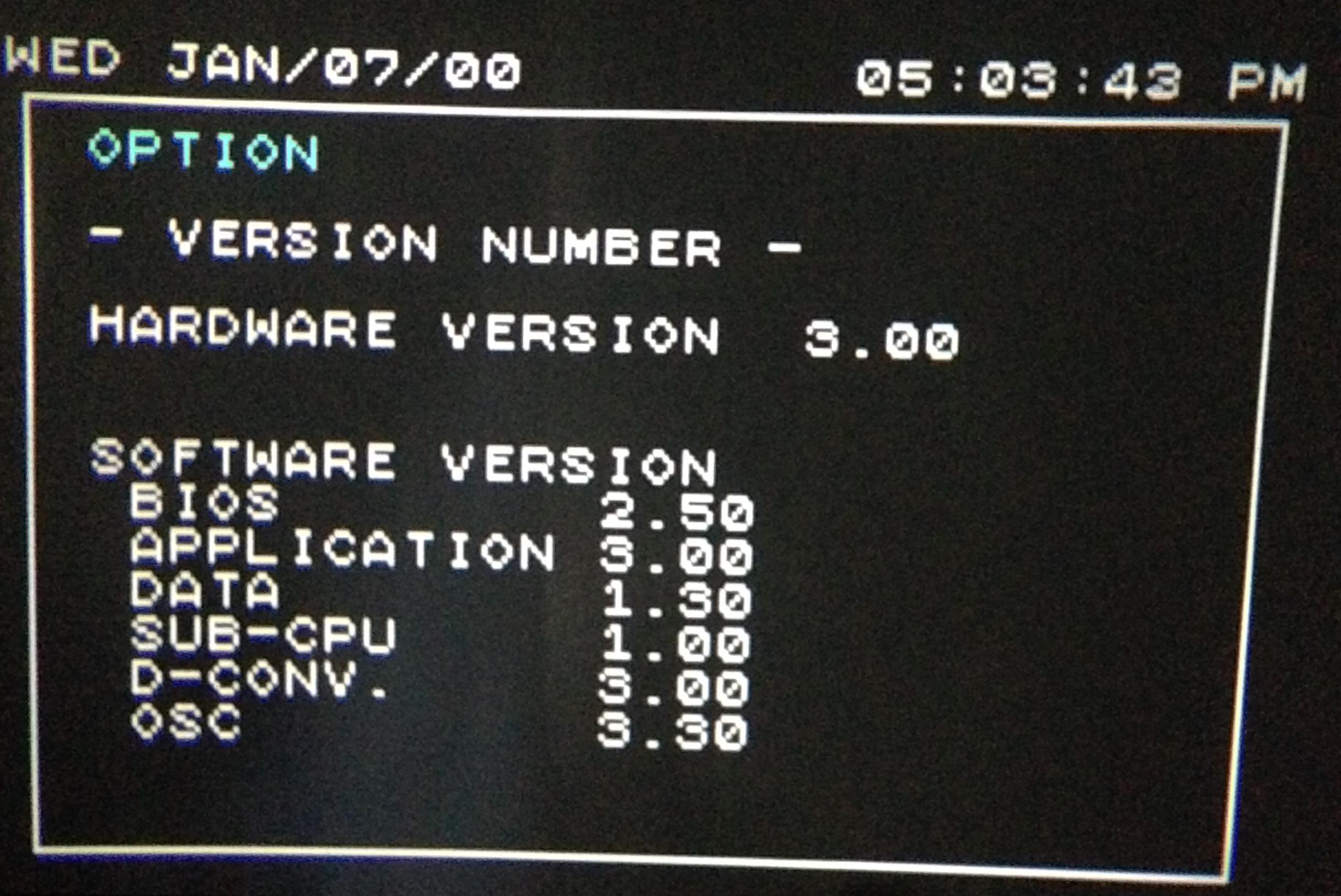

As for model, from the sounds of the previous posts its an 851 ?
Here is a screencap of the hardware versions

Hardware version 3.00 designates a ...2, so yours is a 852.
Error 88 is unknown, error FF is a system board error (the error code list can be found in the NEC XG section of this page, link
