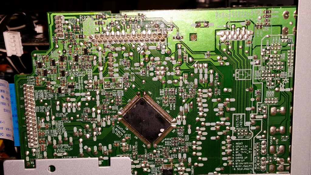

Are you able to take pictures and post them?
jgrice53
Joined: 10 Dec 2014
Posts: 165
Location: marion, sc 29571
Posted: Mon Dec 15, 2014 12:34 am    Post subject:
yes i can post pictures
Posted: Mon Dec 15, 2014 2:06 am    Post subject:
When looking at the front of the receiver I need a picture of the right side of it. I believe there is a board on the side and it is the CPU board. Try to get a clear pic.
jgrice53
Joined: 10 Dec 2014
Posts: 165
Posted: Mon Dec 15, 2014 2:28 pm    Post subject:
okay mac. here are a few of the cpu board. if they are not clear enough for you i will take more.
 Filesize:  382.89 KB
 Viewed:  12679 Time(s)
