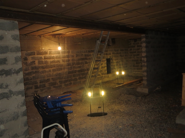

This is what I started out with:

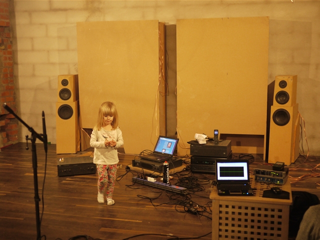

This is a picture from the initial measurement of the rooom to get some info on what to "fix".

Frequency response now (yes, I have minidsp 10x10 HD so it is PEQed) looks like this:
That will change when me and the consultant will do the final and complete adjust of frequency response of all speakers.
