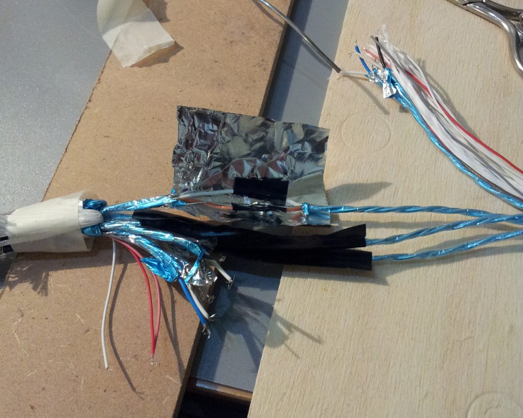

The first thing to do is is exposing the wires for soldering. Carefully remove the external jacket of the cable, leaving 8 cm on each side: you need this length to work comfortably.
Slide down the mesh, then the foil. Unwrap every twisted pair and separate the three wires.
Carefully expose 1.5 mm of the core for each wire; I suggest to use a tool for this operation, since it is essential to keep the exact length of every conductor.
In picture 1 you see the cable cut and ready to be soldered.
Arrange the cables so that you solder them in order, for example clock-wise; if you solder them at random you might have troubles in soldering wires between already soldered ones.

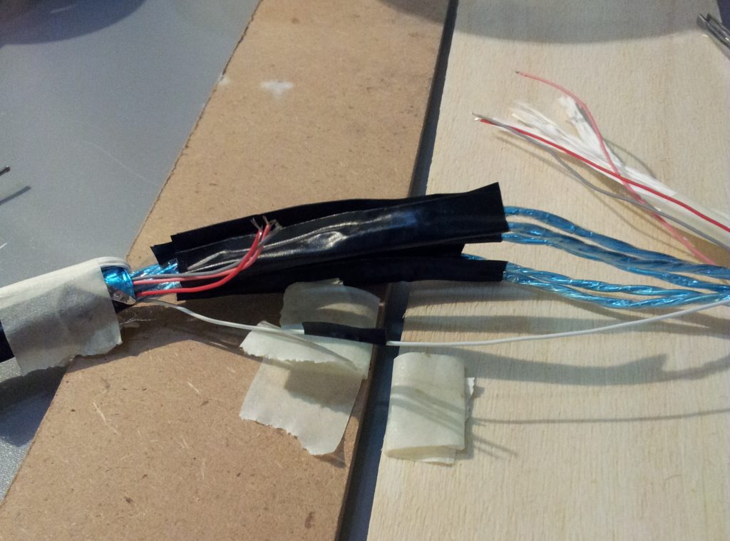

Since I used Wonder Solder, which has a low melting temperature, I avoided using shrinking tubes (heating the tube would desolder my wires); I just used electrical vinyl tape cut in small chunks to insulate each wire.
I wrapped every twisted pair in aluminium foil (the one used for cooking), and wrapped the foil in electrical tape because it is conductive and all the cables will be in contact at the end.
In picture 2 you can see two twisted pairs completed and a third which is being wrapped in aluminium foil.

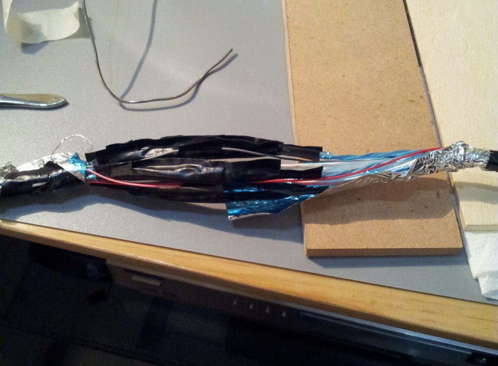

Next, solder the 4 single wires and insulate them (picture 3).

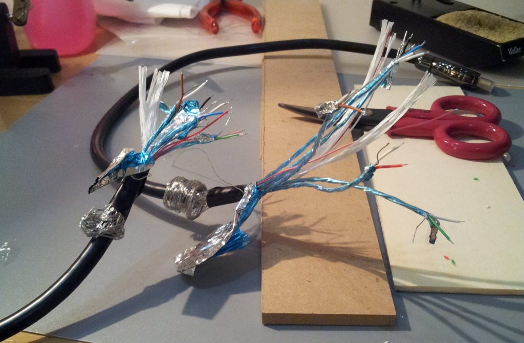

Slide up the existing aluminium foil (picture 4), then wrap the cable with additional foil; slide up the mesh and solder the single, external exposed wire (you will need to add a few mm of wire, since your cable is now a little "fat" where you spliced it).
Finish the cable with vinyl tape.

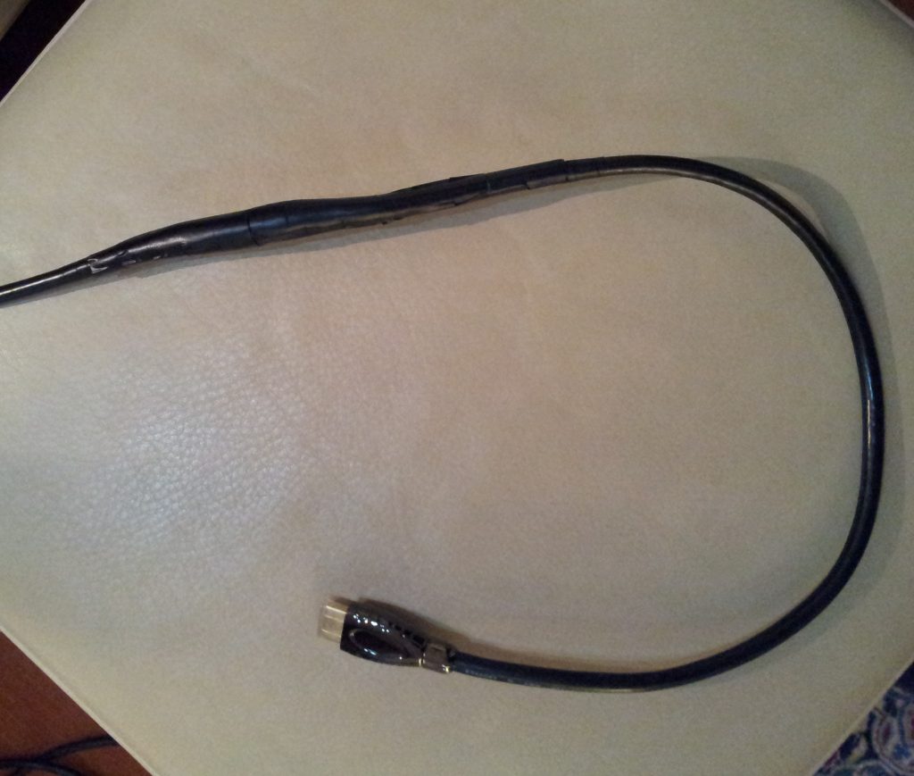

You can see the result in picture 5: not too bad!
It seems a snake having eaten too much, but this cable will be inside a cabinet and nobody will ever notice.
I tested the cable and compared the resulting image with an identical high-quality HDMI cable 7.5 m long.
I could not tell the difference, so I suppose everything is working as it should Smile
