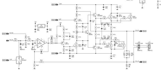

Ok below is a small part of the schematic of the convergence output. Remember I am not an electronic expert so wait on what the experts say. I think I see an opamp I61 with feedback on its inverted input. Such an opamp has Gain 1 + Rf/Rg. See the picture.
Now Rg is the one connected to ground R63 with the value 1k3. Making it bigger would make the Gain smaller. Correct?

Perhaps it is easier to lower the input by increasing R61?
By the way this has to done on 6 resistors for 3 colours x vertical and horizontal.
Posted: Thu Oct 02, 2014 10:20 am    Post subject:
Id have thought the 1k one in line with pin 3 on the opamp would be the better one to increase, but i dont know either.
If we asume the current going into the opamp would be very small than there would be almost no influence of changing that one I think.
Posted: Thu Oct 02, 2014 10:36 am    Post subject:
It should serve to reduce the voltage though

Yes you are right. Only blue and red. This might work Smile

Posted: Thu Oct 02, 2014 10:51 am    Post subject:
Don't think so. The voltage on the opamp side is almost the same as before the resistor because of the low current. I think this resistor makes a rf filter with the cap. I would not change it might even oscillate the opamp.
redfox001
Joined: 16 Mar 2009
Posts: 2257
Posted: Thu Oct 02, 2014 10:59 am    Post subject:
R61 is in a voltage devider with R62 making the voltage R62/(R62+R61).
You can calculate how much you would have to change R61 to get 10% decrease.
2k4/(2k4+4k7)*0,9=2k4/(2k4+R61)
I think 5488 Ohm or close for R61.
And I don't see how this could go wrong but be careful with these smd.

He you might just put a 1k resistor in the wire of the connector! Or even better a pot.

Posted: Thu Oct 02, 2014 2:05 pm    Post subject:
The SMD isnt really a problem, but i wont make changes on a whim, i need to be pretty sure first.
Put a resistor in line with the coil you reckon?
No there is a connector with yellow wires between the controll board and the convergence output board. I once cut the vertical wire and connected to the horizontal for blue and visa versa to know if the control or the conv was the problem.
But what I mean is. You can cut the wires for blue and red horizontal and vertical and insert a 1k resistor. Wrap some tap and ready!

Posted: Sun Oct 05, 2014 11:20 am    Post subject:
Did you try this? I can not see how this could do anything wrong. This means increasing R61 but not on the print but in the connector. The wires are labelled on the print so just try the RV. I calculated that 1k should make the steps 10% smaller.
What you do with this mod is to make the voltage from the controller smaller and the convergence sees a lower voltage. Thats all!
The controller is build to be able to deliver 100 with the mod it might have to deliver 90 and that should not be a problem.
The current is very small so a 1/4 watt resistor is alright.
Posted: Sun Oct 05, 2014 12:32 pm    Post subject:
