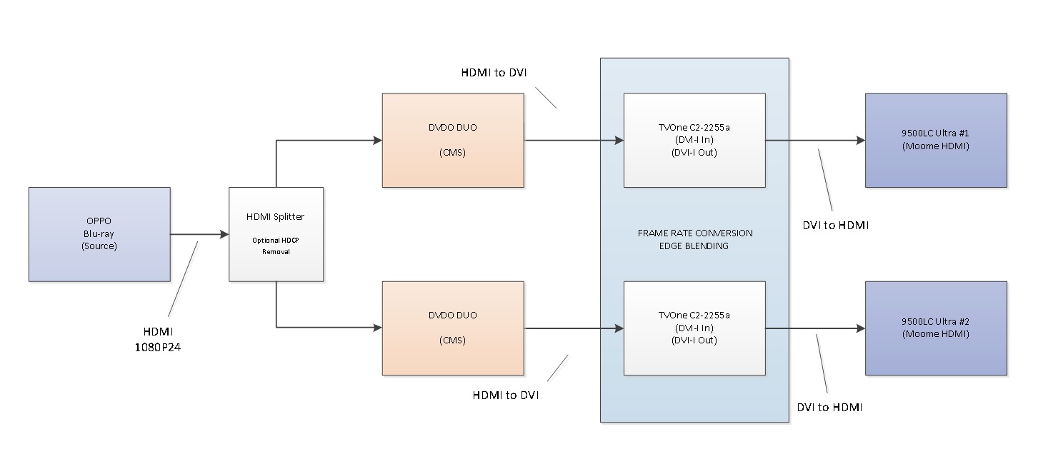

Guys...
I haven't moved the new projectors downstairs yet, but I'm getting there. Carpet goes in this week (I hope), then I'll move them down.
BUT... I just picked up two TVOne C2-2255a units and I'm going to try blending. I can't stand the monster sitting right over my head in the center of the room. The thought of using the full tube faces of each projector and having them much closer to the screen and on the left and right seems HUGE to me! I've worked my way through most of the blending thread started by Nash, and here's where I'm at. I'm going to try to get the color tracking on both projectors equal with the same source using the projector controls (not optimal, but might work).
1. Get greyscale correct with a colorimeter for both projectors
2. Use one as the "reference" and fiddle with the other until it's equal by eye.
Then I'll use the chain pictured below to drive the projectors... Essentially a source into a DVDO DUO to split the signal, then into the DVI-I inputs of the C2-2255a's and then into the projectors.
Questions I have are:
1. Can I feed RGB from the C2-2255a's directly into the VIM's of the 9500LC Ultras? Do they support RGB with combined sync?
2. Do I need to strip HDCP if I'm going to go into the RGB inputs of the VIM (straight)? What about if I go into the Moome cards?
(2a. Which is the best path? Directly into the VIM RGB analog inputs from the C2-2255a's or in through the Moome???)
3. Will the C2-2255a's give me enough gamma correction in case I need to tweak something that I can't get right with the projectors themselves?
4. Are the TVOne processors still AFU, or is there a possible path through them that looks alright (Gosh, I hope they're alright, 'cause I spent a wad on them....)
5. How should I be setting up the C2-2255a's? Anything special I need to be concerned about, any pitfalls?
Anything else that anyone sees wrong with this picture? I'm going to run straight 1080p @ 60Hz through everything. I'm not sure why I'd want to go exotic... Comment on that as well, please...
And no, I'm out of money, so I'm not going to get two Lumagens or something... can't afford that. I'm going to have to make due with what I have (listed).
I'm also concerned about the discussion about offsetting the image towards the center of the tube face and all that... that seems like it might defeat the purpose of blending a bit... how much of an offset do you really need???
What was the final word on this RGB then BGR tube configuration? Is that really necessary? I've seen that it's not, but what's the opinion (not the theory, but the actual results, please).
Thanks a TON for any input you may have!

Posted: Mon Sep 22, 2014 3:36 pm    Post subject:
you'll need two DVDO Duos for separate CMS to each TV one. It doesnt allow separate CMS via each output. At least i don't think it does.

Posted: Mon Sep 22, 2014 3:48 pm    Post subject:
I heard that... but are you positive that the TVOne boxes (or the projectors themselves) won't be good enough? Isn't there some CMS in the TVOne?
I also read in the megathread that if you get the projectors to track to each other natively, then you don't need CMS on each channel...
I suppose good enough is in the eye of the beholder... And I'm probably right there with you in my eye for detecting the defects...

Oh, and could I get started with what I have and then add the second DVDO to the mix when I trip over one?
Can I run one output of one DVDO into the next (i.e. letting the first DVDO split the signal, and the second do the CMS)?
Posted: Mon Sep 22, 2014 4:47 pm    Post subject:
Is it not possible to run 1080P 24hz source direct out of a OPPO player, using both HDMI outputs, and direct into each TVOne, maybe put a 20$ stripper betwen on each output, and then convert to 60hz in the TVOne units, and please use the moome HDMI input, as it has the best DAC you will be able to find.

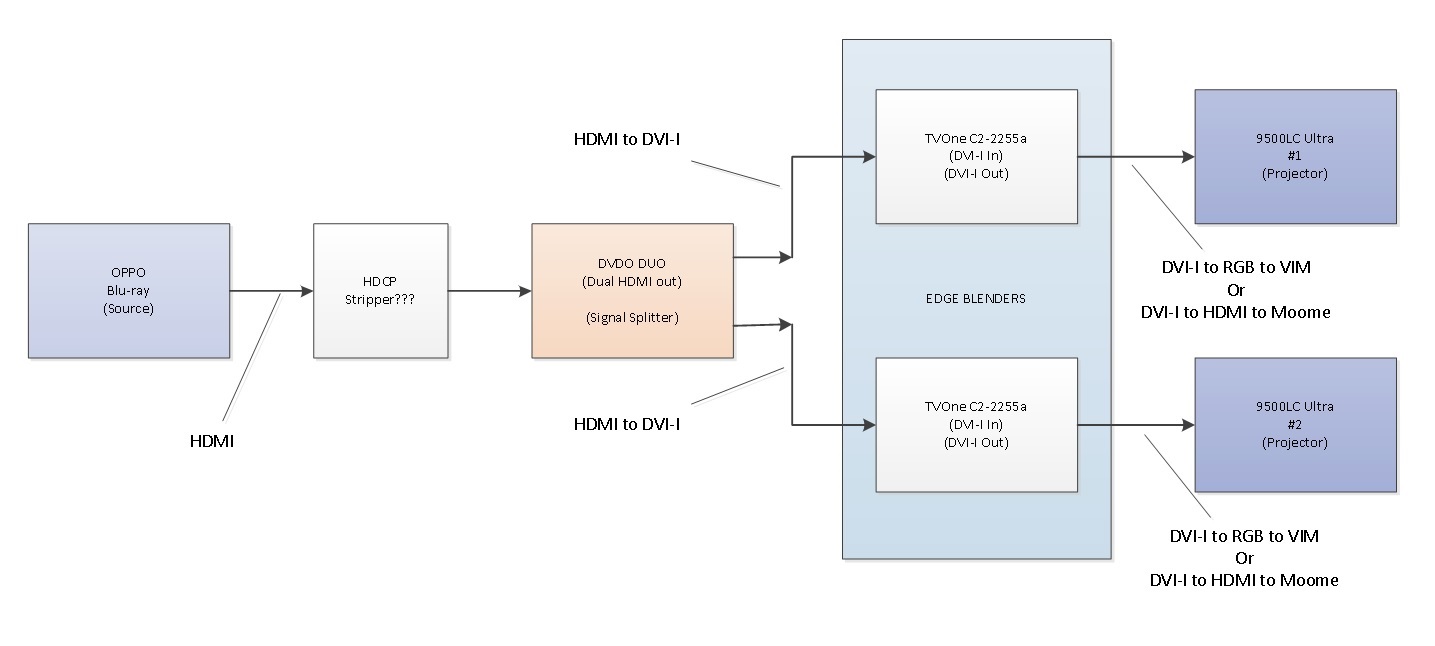

Posted: Mon Sep 22, 2014 6:05 pm    Post subject:
So, are we talking about something more like this?
I'm placing the DVDOs after the TVOnes to make sure the CMS is in more than an 8 bit domain, but to be honest, I don't even know if the DVDO is more than 8 bits...
Should the DVDO's be before the TVOnes?
If I use the Moomes then I don't really have to worry about HDCP it seems...

Posted: Mon Sep 22, 2014 6:18 pm    Post subject:
I would keep the DVDO out of the chain, and do your best with the projector options, you already have the TVOne processors in the chain, so ill guess that you will be able to pass a more natural and dynamic image with less processing.
The stripper should only be if the TVOnes have issues with HDCP.
Depending what oppo player you use, the HDMI splitter/ stripper might be a good idea, as some dont output the same quality on both HDMI outputs, as far as i know thats the case with the players using Qdeo processor.
The OPPO 103D will do right as long as its 1080P 24hz source direct, other than that it also processes each output different.
There is som huge quality trade in for a CMS in the chain, but if its impossible to match the projectors, you might need to do the trade.

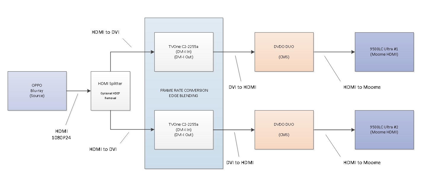

Posted: Mon Sep 22, 2014 6:23 pm    Post subject:
You should put the Tv-Ones last. That way you can go to a 72hz refresh rate.
Also the TV-ones are suppose to be HDCP compliant but dont like the encryptions. So I use a HDMI splitter before the radiance then that to the tv-ones.If you want then you can bypass the internal moomes and go RGBHV but i wanted a single cable to each PJ so I went HDMI.
The TV-ones have no CMS. Getting two PJ's to match with no CMS is almost impossible. I found not only Greyscale and Gamma must match but for a truly invisible blend zone you need, equal gamma, greyscale, color gamma, hue, saturation, lightness basically it all has to match from black to 100 white. Mine is not perfect but i watch it.
The hardest part is doing the zone contrast in the marquees. I still have not nailed that yet.

Posted: Mon Sep 22, 2014 6:30 pm    Post subject:
Alright... So then the assumption would be that the HDCP may be OK all the way through the chain because the Moome cards are able to handle it at the projector.
The TVOne's seem to have some sort of CMS in them, but I believe at the end of Nash's thread he says that the CMS is messed up (due to some issue at level 128, some kind of folding). I'm not too clear on that.
I like the simple chain, and the TVOne boxes seem to be very capable... I just don't think they're better than 8 bit per color (24 bit), and I don't know yet whether that would make a difference.

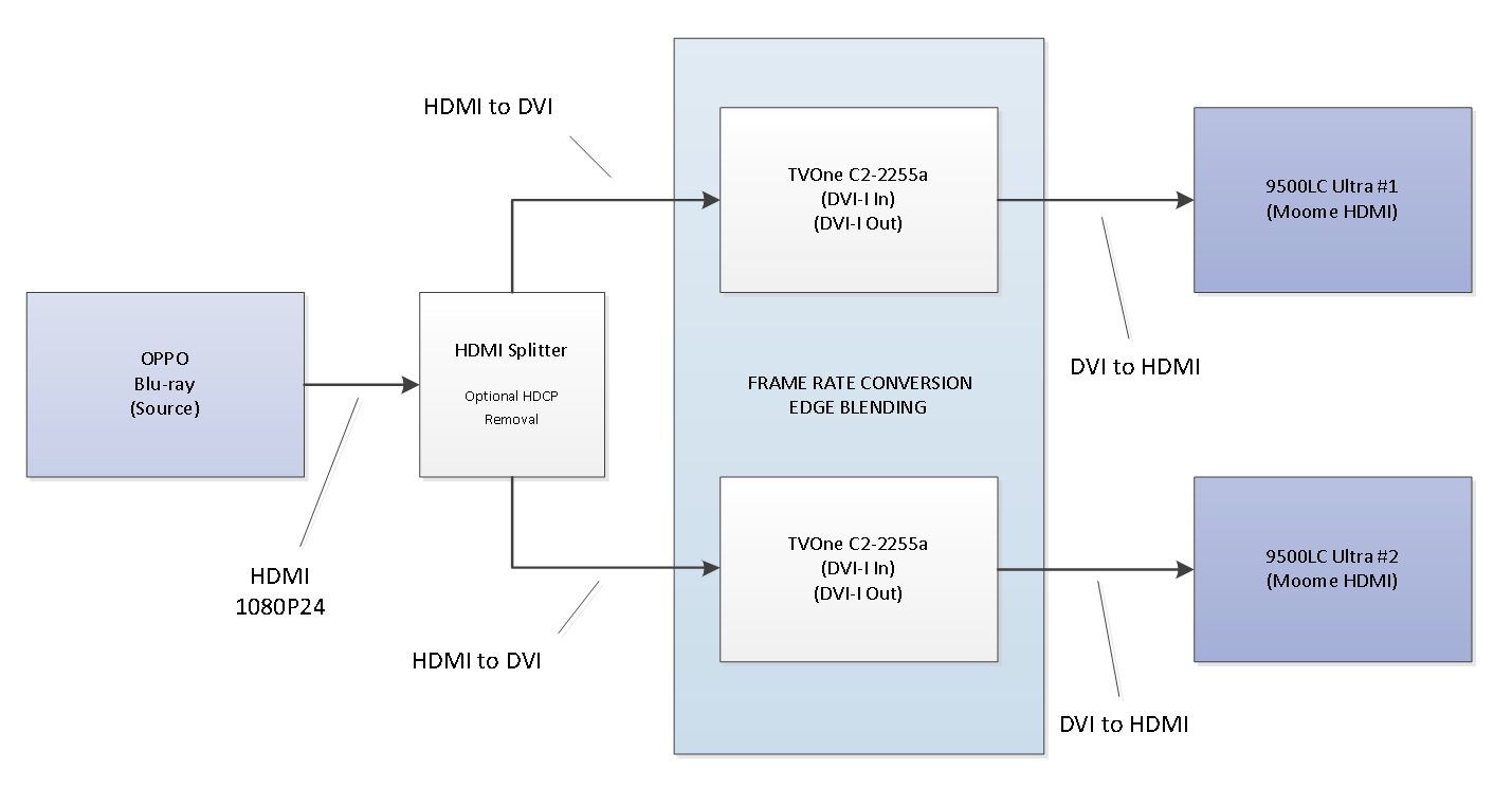

Posted: Mon Sep 22, 2014 6:37 pm    Post subject:
Nash, I hear you...
(see below)
What about CMS with the boards you can get for the projectors? (or am I mis-understanding something)
Do you see gradients during fades?
Also, it looks like the C2-7100 will only accept up to 1280 x 1024 via DVI-D... that's not good, I guess... I'm trying to figure out if the units that I have (C2-2255a) will do better. Or maybe this doesn't matter???

Posted: Mon Sep 22, 2014 7:32 pm    Post subject:
I cant see that the DVDO CMS is advanced enough to correct the calibration if the 2 projectors dont track pretty much the same. Or did they add the 5X5X5 or higher recently.?
Posted: Mon Sep 22, 2014 8:56 pm    Post subject:
Melifluonze wrote:
Nash, I hear you...
(see below)
So you have both the C2-7100 and 2 of the C2-2255A's? Either will do the "A" units are newer and will go up 220mhz clock rate undocumented by a TV-Engineer .
CMS or Color Management System is not possible at the levels of the DVDO or radiances . Basicly in the marquee you can only set two points for grey scale. With the Vp's you caN GET 11 POINTS of greyscale and 21 points with the Lumagen Radiance.
You would have to come down to see my set up before you start. It might not be your cup of tea.
