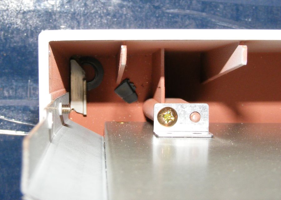

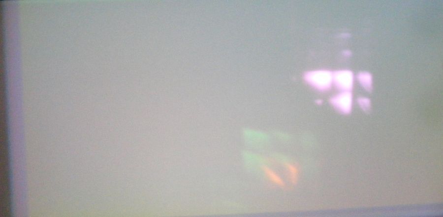

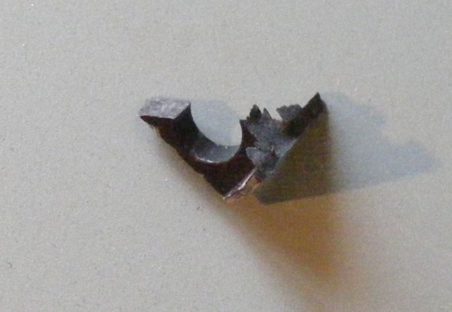

UPS still managed to break it. At first I thought it was just the power button. BUT When I opened it up to fix that I found 'bits' floating around and a random screw. Once piece was a corner piece off of something, couldn't see where it was from but when I powered it up I had a triangular light leak on the screen. Coincidence? Hmmmm....
United Parcel Smashers smashes another one!
That must have taken one hell of a hard hit to snap the insides like this:

Took it all apart, Gorilla glued the broken corner on, and dusted out the light path. Then I checked EVERY connector. Found out it was the top board. There's a set of edge connectors on it and the screws were loose. Allowing it to shift in transit and unplug from the light engine.
