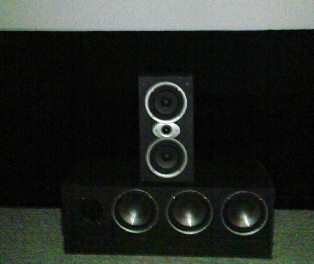

I finally finished making my center channel speaker. Its 28 inches tall, 32 inches wide, weighs 103 pounds. It will run 500 watts per channel RMS @ 8 ohms and matches the rest of the system perfectly. I ended up using one A9. I ran a Y splitter out of the integra to the left and right on a Yamaha M80 amp. Ran the MTM off channel A and the 3 woofers off channel B. Oh yeah, and it sounds f*cking amazing.

Posted: Thu Jul 24, 2014 1:56 pm    Post subject:
[img][/img]

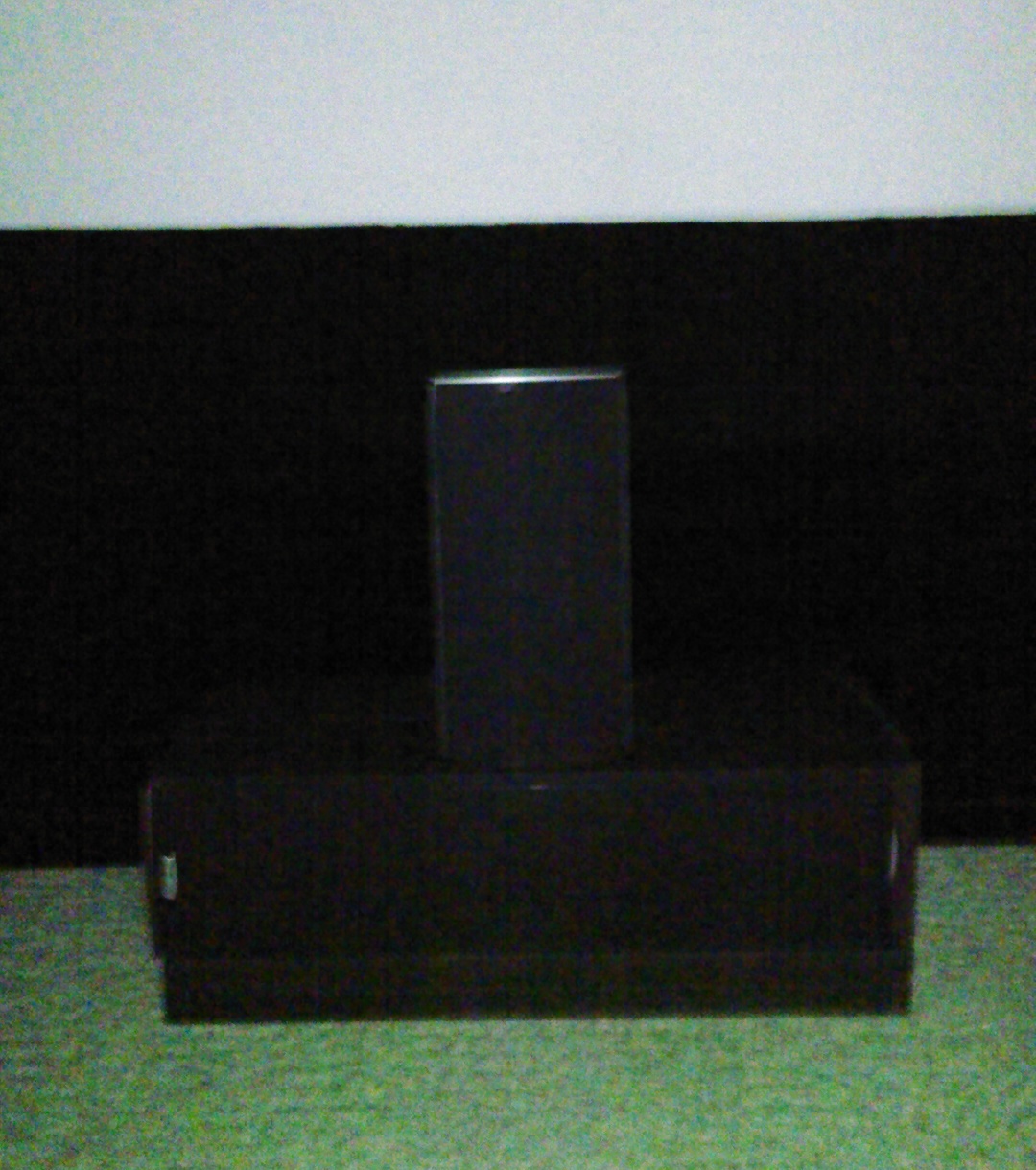

Posted: Thu Jul 24, 2014 2:01 pm    Post subject:
[img][/img]

pretty bad pics but I guess you get the idea. I sure aint much of a carpenter but the sound is really a night and day difference and to me that's what really counts. The vocals are loud and clear, more like a movie theatre than ever and the sound just flows around the room. I don't have the vocabulary to explain it so I'll just say I love it.

Well, after a few days and several movies and TV shows I am pleased to say how much I love my ugly ass center channel. I had an A9 on its side as a center for awhile and it wasn't bad but using it in this way is night and day difference. The more I hear it the more I am amazed by how good it actually improves the entire soundfield. My wife loves it. Vocals are crystal clear and running in full range it brings so much more presence to the room. I am running it with a Yamaha M80 amp using a Y splitter off the integra. I changed it to just using channel A left and right. The one issue I have (which really doesn't seem to matter) is that I cant use the test tone from the integra to set the level on the woofers as the crossover cuts it out. Maybe someday I will have someone with woodworking skills make me a pretty cabinet. The upside is in the dark when movies are on you cant see it at all. You sure can hear it though.
