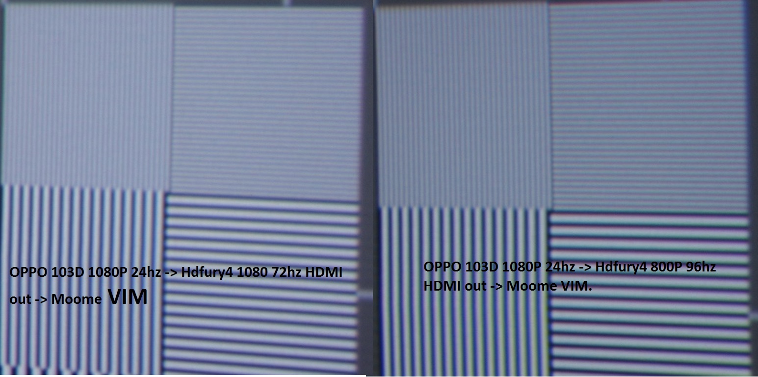

Posted: Tue Jul 22, 2014 8:55 pm    Post subject:
OPPO 103D 1080P 24hz -> Hdfury4 1080 72hz HDMI out -> Moome VIM.
178Mhz

Posted: Tue Jul 22, 2014 9:14 pm    Post subject:
OPPO 103D 1080P 24hz -> Hdfury4 800P 96hz HDMI out -> Moome VIM.
187Mhz

Easier to see with side by side comparison.

Posted: Wed Jul 23, 2014 5:02 am    Post subject:
The problem is that you cant use my Pictures for sharpness evaluation.
Its ment as a bandwidth evaluation.
Every time you change resolution, the convergence focus and geometry changes, and i dont do a full blown setup to shoot these bandwidth tests.
Also the camera autofocus can be off, and its more and less a free shot, no fancy camera setup.
