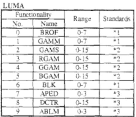

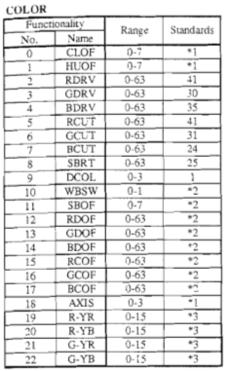

What I have found is that the crt has sony's 'cinema drive mode' (3:2 pull down). Apparently with film-based material with bad 3:2 cadence errors (mixed 3:2 sequences) it seems to detect 3:2 and has a very small 'recovery' time when 3:2 cadence is interrupted. It's telecine function has been described as 'quite good'. So I have no reservations pursuing the best I can get out of the setup within reason knowing it will handle 1080/60i well.
So its down to the 83 (used) or 103 via hdmi and a moome card. It all hinges upon whether one of the oppo's provides better quality 1080/60i than the other. Given this is an usual thing to do with the advent of progressive displays my searching has come up short on this question. Any thoughts on this or the picture quality of the 103 vs 83 more generally stridsvognen?
I have also found the extent to which the crt's LUMA and COLOUR can be adjusted via its service menu (pics below). Given this I wonder how much benefit a simple CMS would provide. To avoid the cost and setup headaches of a lumagen I am thinking of the 1D videoeq mx (US$500). It's main benefits would be 21-point grayscale and more accurate controls in the 0.1 range.
