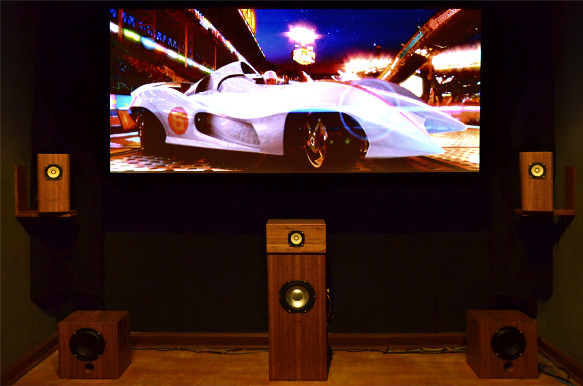

I acquired a G70 from Curt this winter as part of a refurb of my 10 year old dedicated HT. Previous proj was a Dwin TV3. I was recently asked to take some pics of the setup so I thought I would add them to the database here for those looking for set up ideas for a reasonably priced system that delivers a high quality end result.

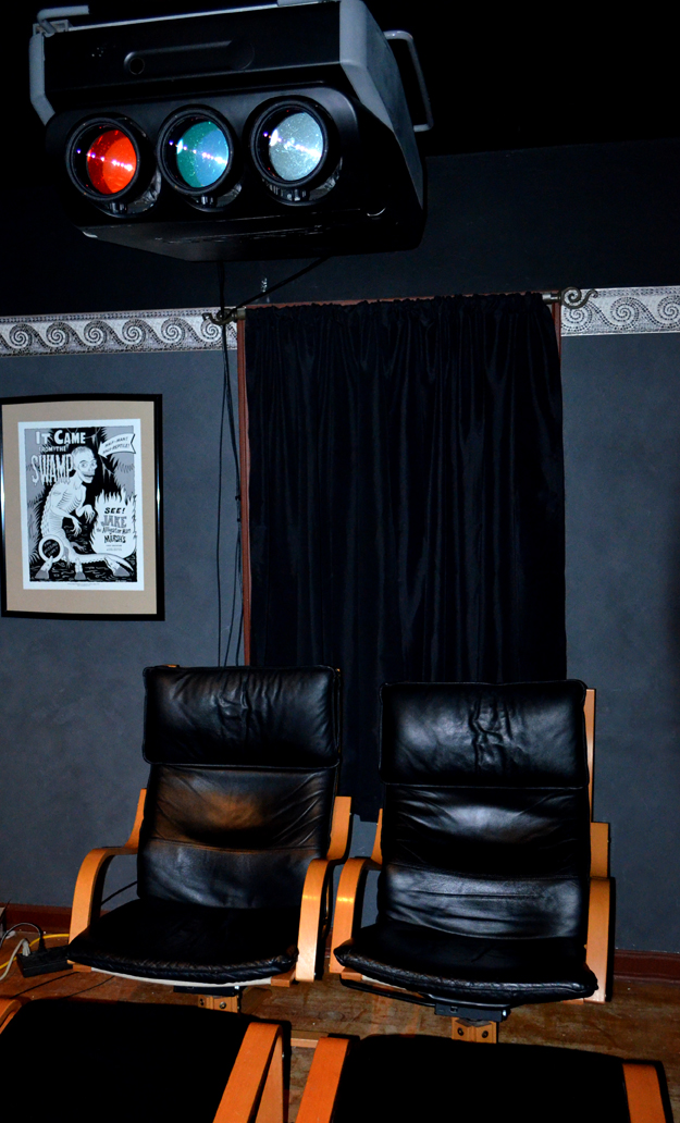

The room is small, about 11' x 14'. Front wall and ceiling are painted flat black, other walls a dark gray suede texture, and trim is a fairly dark brown. Windows have been treated with panels composed of 1"x2" frames filled with 1" thick Bonded Logic cotton batting and felt weather stripping around the edges to block light. Black curtains hang over the paneled windows. A black patterned rug is on the maple floor. Furniture is a couple of black Ikea Poang chairs with swivel bases and ottomans. A single track light with a remote dimmer lights the room when needed and there are theater style night lights in the AC outlets near the seating area
The screen is 96" diag 16:9, Wilsonart Designer white laminate with a black velvet covered frame. Top and bottom masks are strips of styrofoam insulating panels covered with black velvet and suspended from a pulley system to allow easy manual adjustment. Side masks are simply black curtains on short rods with fishing weights on the inside bottom corner to make the curtain hang as vertically straight as possible.
The speakers are all from Blumenstein Audio - Orcas and Dungeness subs for the fronts, an Orca center channel for the center, a BUF sub for the effects channel, and more Orcas for the surrounds.
Amps are all our own Bottlehead products (natch!) - A Stereomour runs the fronts, and our S.E.X. amp runs the surrounds and the center channel.
The G70 has a Moome HDMI card. I'm using an Oppo BDP-103D as source and also have a Mac Mini running into the Oppo rear HDMI jack for streaming Amazon.
The room makes a very cozy little theater for my wife and I and we can squeeze a couple of guests in when necessary. Loving that G70!

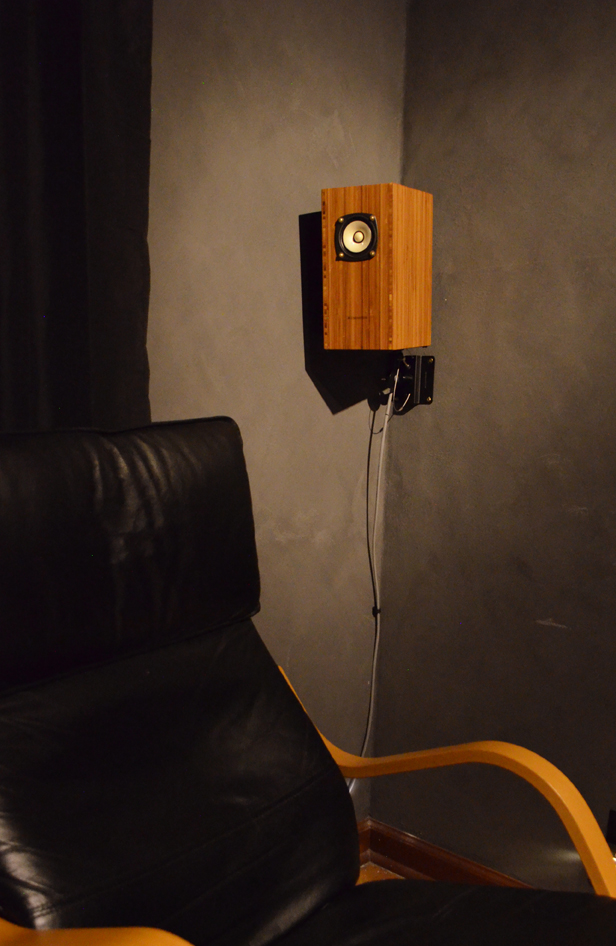

I love the Wall side mounting speaker shelves!!!

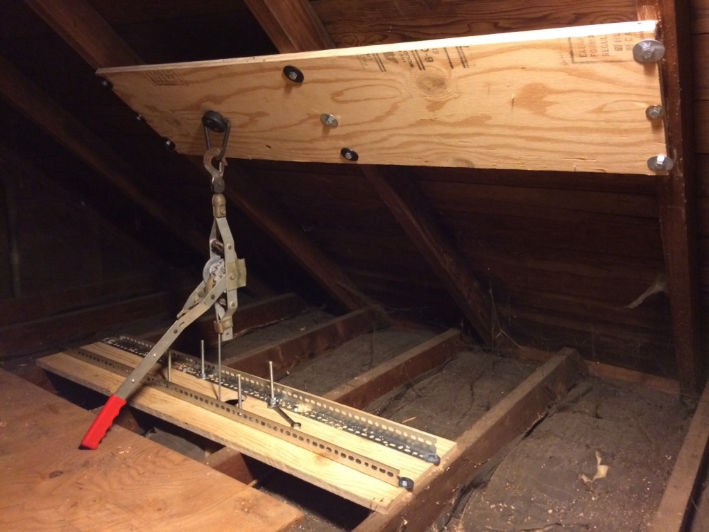

Image thrills me, installation thrilled me not so much. Reinforced my ceiling and installed 10,000lb rated lifting rings to lift the G70 in place with a comealong in the attic. After we got the projector wrestled onto the mount I realized I couldn't get the comealong's hook off of the projector's lifting ring. So it's still up there. I tell everyone it's so we can lower the projector to change the oil filter and the spark plugs. I also put in some new fans that did a nice job of lowering the noise floor. Much more quiet than the old Dwin with it's five roaring fans.

Posted: Tue May 13, 2014 2:03 pm    Post subject:
Very nice! I spy Fostex full rangers in the LCR and surround speakers, correct? Bet those have very nice dialog clarity (true point source, no crossovers).

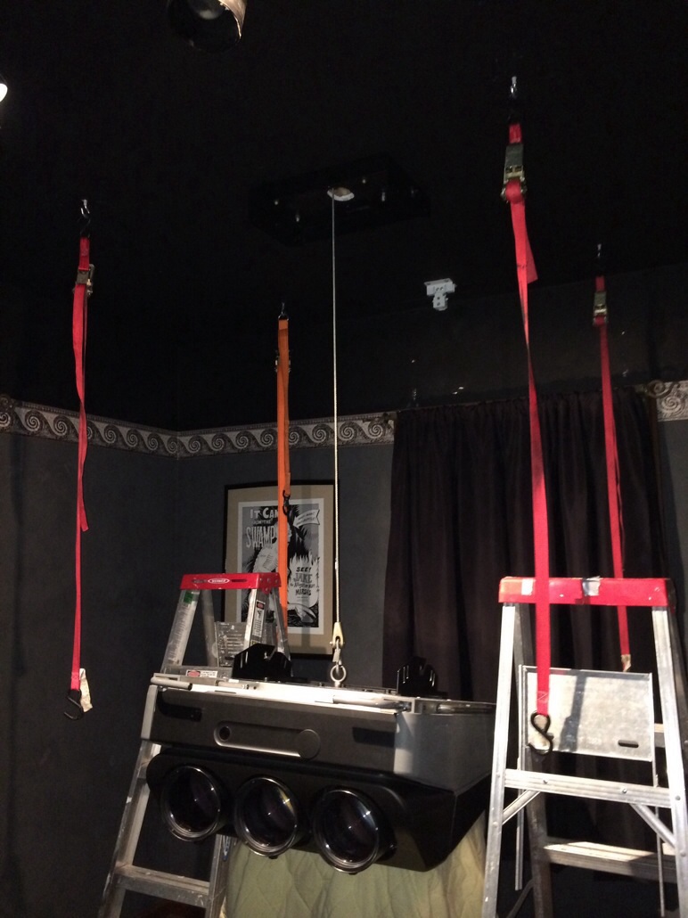

Great installation for the projector hoist. What are the other cargo straps for?

Yes the drivers are Fe83s. I use an line level baffle step corrector we make called The Fix on the mains, which helps even out the lower midrange and upper bass for music content as well as bringing up the slightly rolled treble. Dialogue from the center is indeed very clear. I'm quite happy with the sound.
The cargo straps had not come down from my first attempt to raise the projector when that photo was taken. It became pretty obvious three of us were not going to power lift the thing the last foot or so where the straps had a really steep angle on them, so I went to plan B with the comealong. We feel quite safe sitting under it, but now I do think about how badly I need to insulate that attic.

Straps: Ah! Makes sense. My approach has typically been to use a 5:1 pulley set up with a heavy rope, with half the pulleys in a ceiling installed bracket and half on the set's bracket. The come-along is a good option, but I've heard not as trustworthy as it should be.

Yeah they really worked out well for this application. The only thing you need to be careful of with the Fe83 is the limited excursion. Crossing them over fairly high to the subwoofers helps a lot, and I use 4 watt amps with them. With plate amps on the subs the system gets plenty loud enough to register complaints. Being a music industry guy they work well for my emphasis of musicality over whiz bang. The second choice would have been my bud Andrew Jones' Pioneer signature HT speaker setup. That is an amazing system for $500. Unfortunately it tends to get packaged with inexpensive Pioneer receivers which in my opinion can't reveal the speakers' true potential.
Re comealong trustworthiness, I've had that one for maybe 20 years and it never asked to borrow money or flirted with my wife. But it has dragged a 3300 lb. Mercedes with seized brakes onto a trailer and straightened a bumper or two. Lifting the 175lb. projector was pretty smooth and easy. Modifying the mounting bracket with the lifting ring and putting all that junk in the attic was the hard part.
