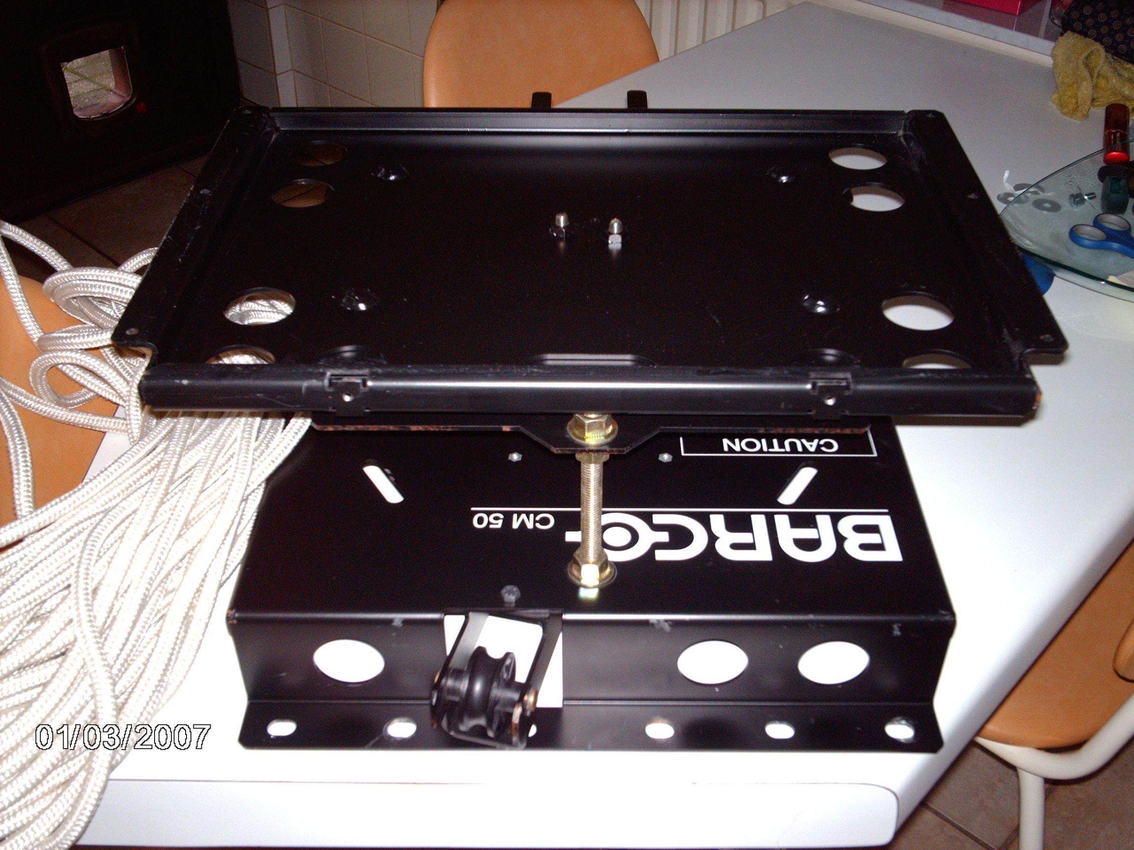

You need an original CM50 ceiling mount with pulley for that baby ? Very Happy

Posted: Sat May 31, 2014 7:53 am    Post subject:
Have you one?
Now I can't lift the baby until they works.
Any suggestions for the COINC issue?
Domenico (Barco fan!)

Posted: Sat May 31, 2014 8:42 am    Post subject:
When the coincidence LED is lit, it means that the projector is locking to a signal ( external source or internal menu ), so don't worry about it. It is normal.
Yes i still have the ceiling mount from my former Cine 7. Send me a PM if you need it.
