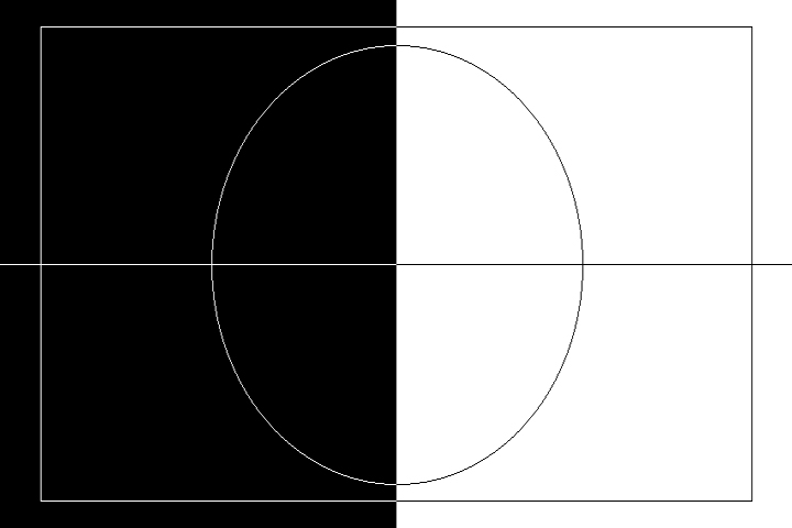

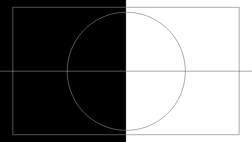

OK, I saved a few images out for you. .7v p-p should be IRE100, or full-white, so I saved the file out. Of course, you're relying on the Panny BD player to send the right signal out, but it sounds like you don't have much to lose at this point.
I'm guessing the Panny player will be expecting square pixels, and won't stretch the 720 image, so I gave you both 852x480 and 720x480. I also gave you a version with a border at around the 10% under-scan point so you'll be able to see if the image is displaying full, or if it's the player is adding some black border to under scan the image - some of them do that.

Posted: Fri Apr 11, 2014 8:18 pm    Post subject:
Hey those look amazing...the first and the last being the ones I will try first. I am really looking forward to seeing how these come out of my BD now...hope the silly thing doesn't show them as a "slide-show" with borders and filenames and junk around them...its been so long since I tried an SD card I can't remember!

Posted: Wed Apr 16, 2014 7:16 pm    Post subject:
Yay - happy to report my set is back to properly calibrated vertical size now...thanks Ecrabb!!! The first test pattern was the one that worked. I am happy because the damn hockey game scores on TSN aren't partially cut off anymore at the top... go Canadiens! ( only one team to cheer for here in the great white north, sadly !)
Posted: Wed Apr 16, 2014 8:50 pm    Post subject:
Cool. Glad they worked out.
Did you ever try displaying the other two? Just curious how the Panny BD player handled the two different aspect ratios.
