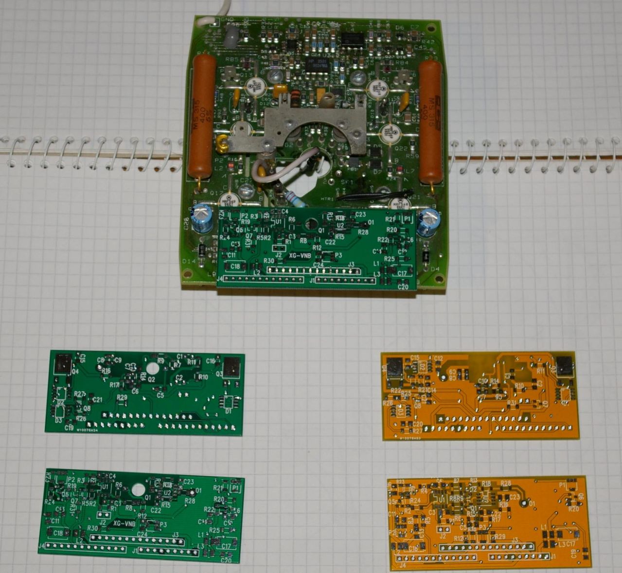

So in the meantime the PCB for the daughter board got ready, actually there are two versions...
I already built the first prototype board, modifications had to be done in the local power supply, but otherwise the circuits working quite well.
I've measured 2ns rise time at 2Vpp output, with this circuit. If we take into account the limited rise time of the oscilloscope and my pulse generator that gives about 400MHz bandwidth for this contrast control circuit,
Practically this means this circuit will hardly affect the signal bandwidth passing to the VNB.

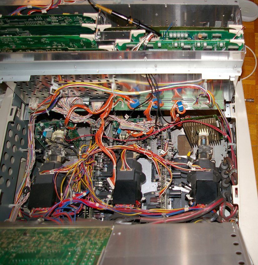

Heavily modified Electrohome VNBs in a heavily modified NEC PG xtra, these neckboards should fit in the XG!

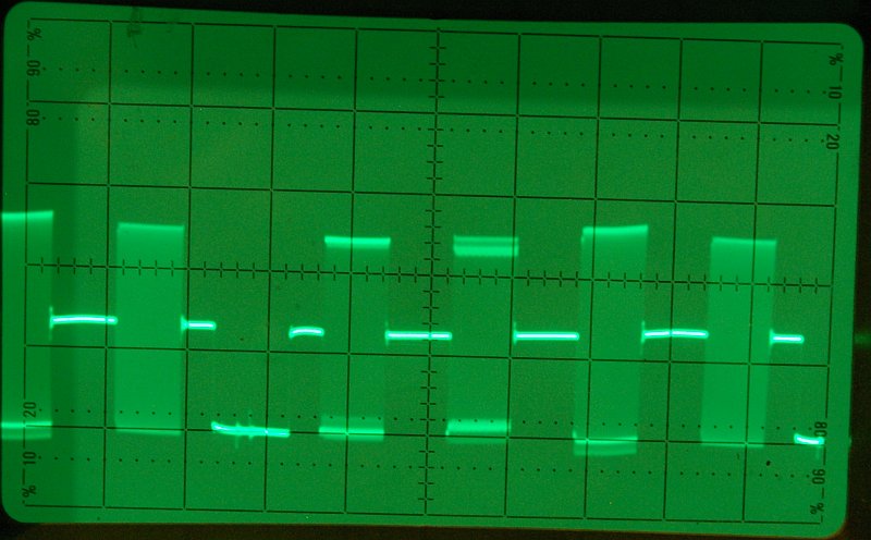

So this is how 1080P 60Hz multiburst look on my XG-VNB board's G1 output.
Source GeForce 6600GT VGA card
-The VNB is "stock" performance wise, only the needed modifications were done to perform in the XG, no further peaking mods were made.
-The daughterboard uses AD834, 2SA1765, CLC449 main parts.
-Output at ~50Vpp (20V/div vertical)
-HP 1120A FET active probe without, other loads
-What is odd is that if I add a 10pF cap on the output the overall signal shape does not change significantly.
-K output looks similar too.

Posted: Mon Feb 22, 2016 8:41 pm    Post subject:
Great! So it looks like the bandwidth problem can be solved with sound enginering in stead of replacing random components. Super!

The peaking inductors are much smaller than on Barco so 10pF makes a resonance at 277MHz with 33nH. Could this mean that those neckboards can do much more? Really rf?
Posted: Mon Feb 22, 2016 9:02 pm    Post subject:
At this point I'm not too concerned to push the bandwidth limits. My original goal was to replace the original neckboards with a better performing one. And since my target resolution is 1080i 96Hz (aka 1808P 48P) as seen 1080P 60Hz looks nice so the bandwidth criteria is acomplished.
There is some waviness on the grey level, that -I'm affraid- I will see on the screen too, so I have to move on with real testing.

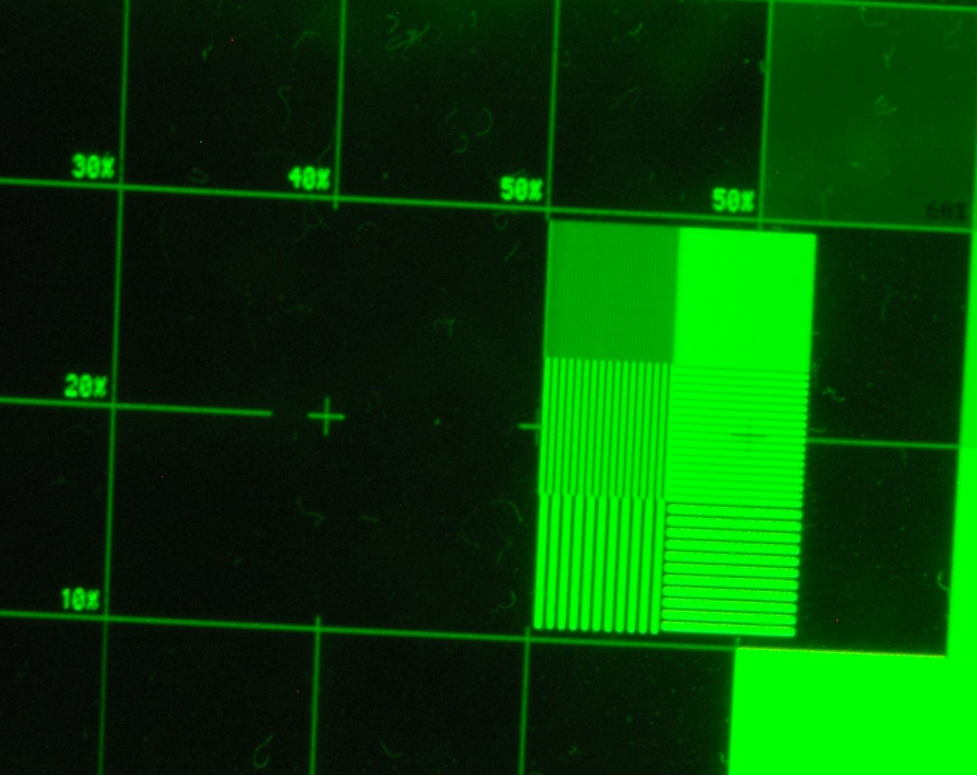

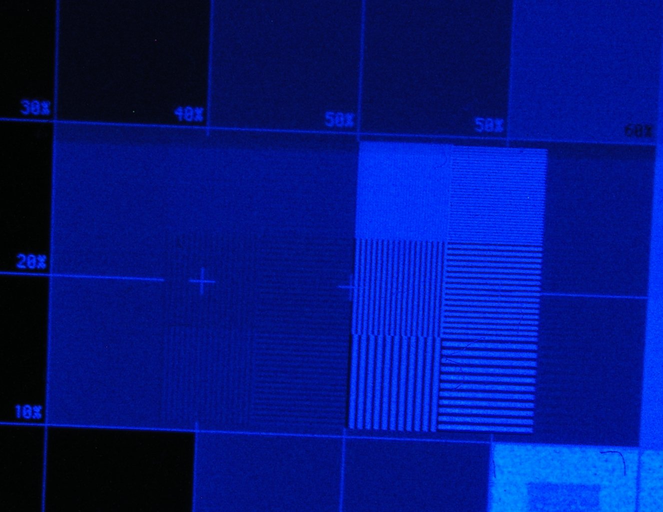

Posted: Sun Apr 03, 2016 7:15 pm    Post subject:
XG-VNB card in an XG75
Green as reference with a NEC CRT amplifier
Blue is the experimental XG-VNB CRT amplifier.
1080p 60Hz.
XG-VNB 1080p 60Hz
 Filesize:  223.9 KB
 Viewed:  16269 Time(s)
Green reference 1080p 60Hz
 Filesize:  184.09 KB
XG-VNB in XG75
 Filesize:  256.12 KB
 Viewed:  16270 Time(s)
