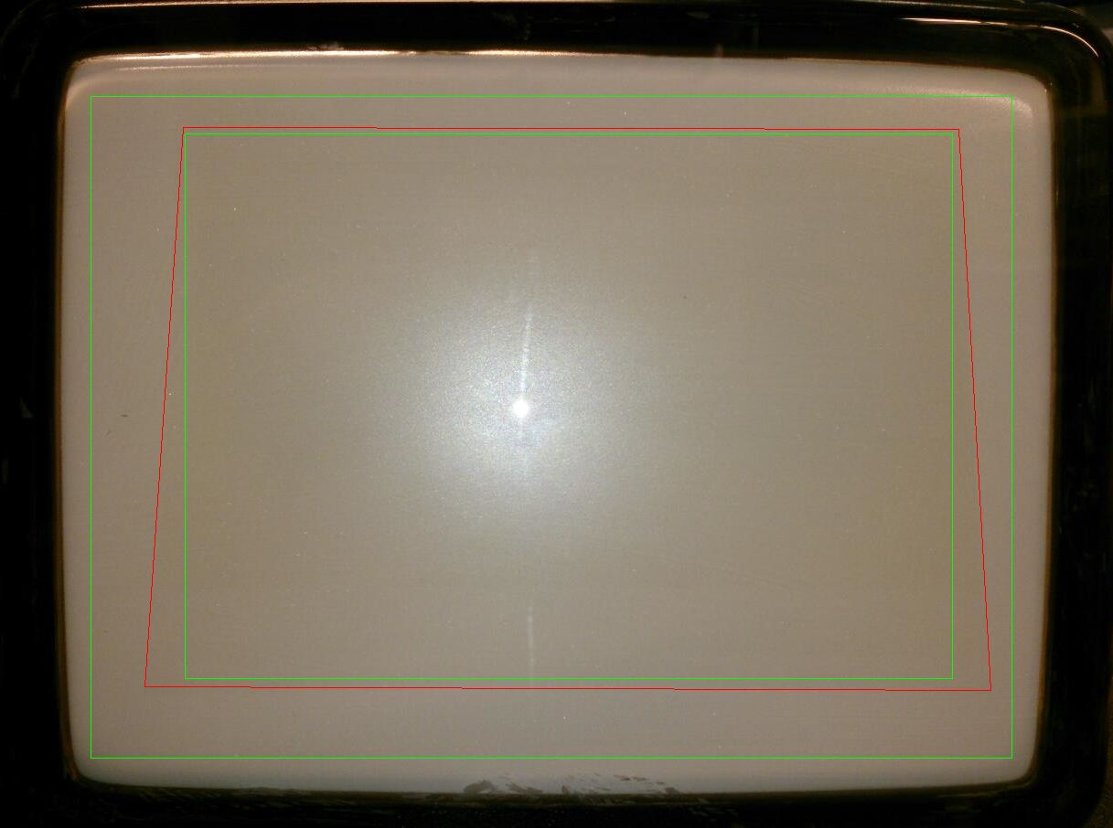

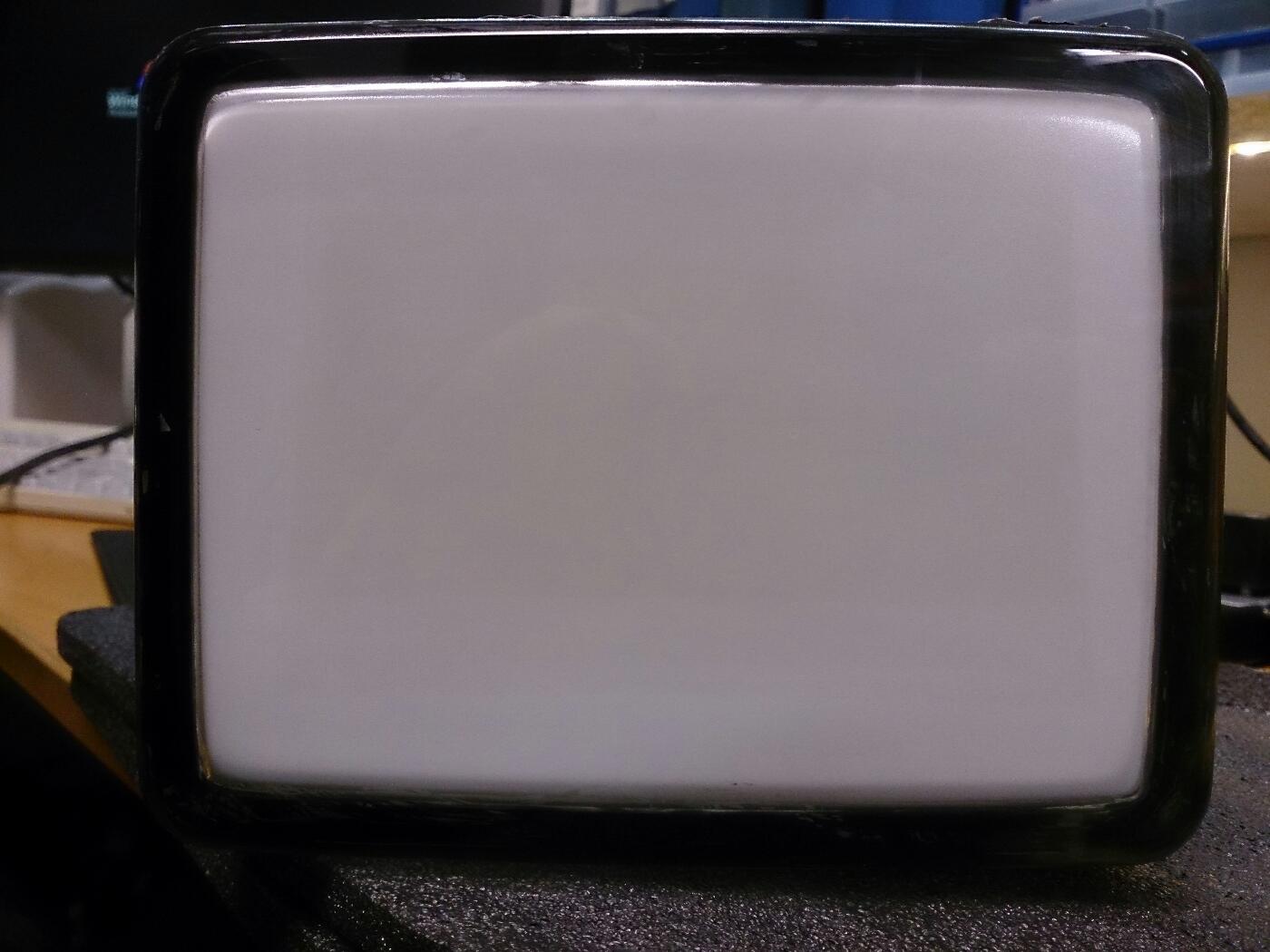

Parted the renaming two tubes from their housings today which I intended to use with new scheimpflug housings. So far so good, until I held up the tubes at an (un)favorable angle. There is wear on the blue tube and a hint on the green. Previous owner had low ceilings and hence the projector mounted flush at zero degrees with a characteristic wear pattern as a result. As always it's hard to capture. Let's just say they are more pronounced in real life than what shows up in the picture.
What are my options? Keeping within the wear area will just mean unfavorable mounting position and premature wear on the other tubes (red is like new, green has a hint of 16:9 wear which is only visible when it's out of it's housing and held at the correct angle against the light so I would say an 8) which to me is shooting myself in the foot since I will deliberately be raising running costs and decrease resolution.
Also, I'm that annoying person who writes letters of complaint to the managers of cinemas when the convergence is off, 3D polarization images don't match up to the millimeter, the masking is off and similar so I will for sure notice color differences in the image if there is a edge. There is a small difference though in that the cinema costs $10 an hour and the CRT is about $0.05-$0.5, depending on how long I let the tubes go, so I expect perfection at the movies.
If I run a full blue image and adjust the image to cover all of the surface area minus minimal safety area, will it blend out? Compensate by using a negative image in my HTPC/scaler?
Learn to live with it and it will blend out over time?
Tune a negative image on the blue tube and run it over a few days to wear the rest of the phosphor to the same level?
Suck it up and get a new tube?
Other option?

Melifluonze wrote:
Posted: Mon Jan 27, 2014 12:46 am    Post subject:
Nothing wrong with those tubes...
Posted: Mon Jan 27, 2014 12:47 am    Post subject:
Buy three tubes and get three housings free!!
Posted: Mon Jan 27, 2014 3:18 am    Post subject:
Those tubes are fine just keep the image in the wear zone and you won't notice it.

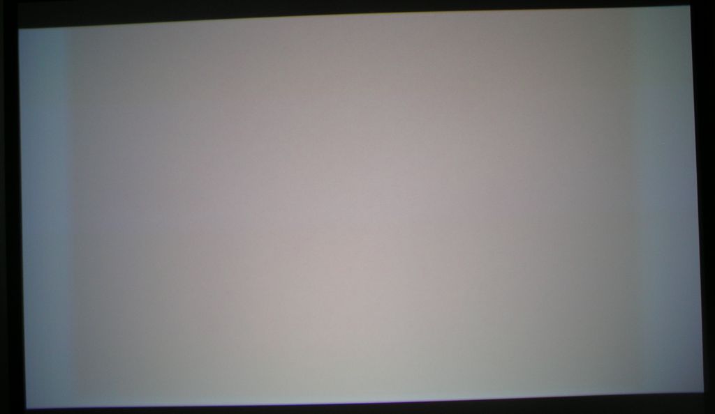

I'm deadly afraid to end up with a picture like this:
At first I thought analog CRT will be great because I could throw whatever aspect ratio and non-square pixels at it and also not wasting any resolution for things like keystone correction. Although this holds true at first, switching between 4:3, 16:9 and 2.35 will dramatically lower the usable service life. Also, if you need to move at any point in life, chances are high you will end up with a bad compromise.

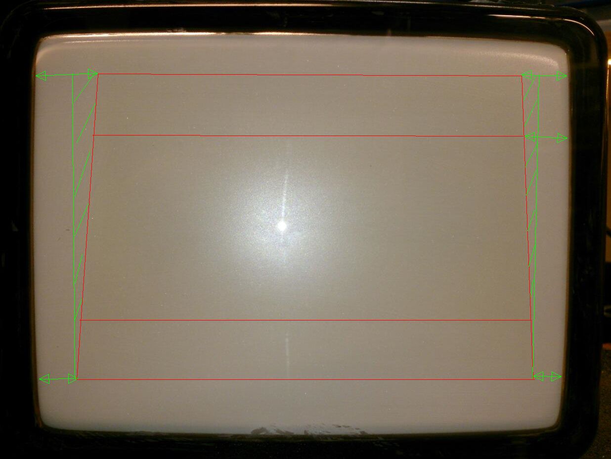

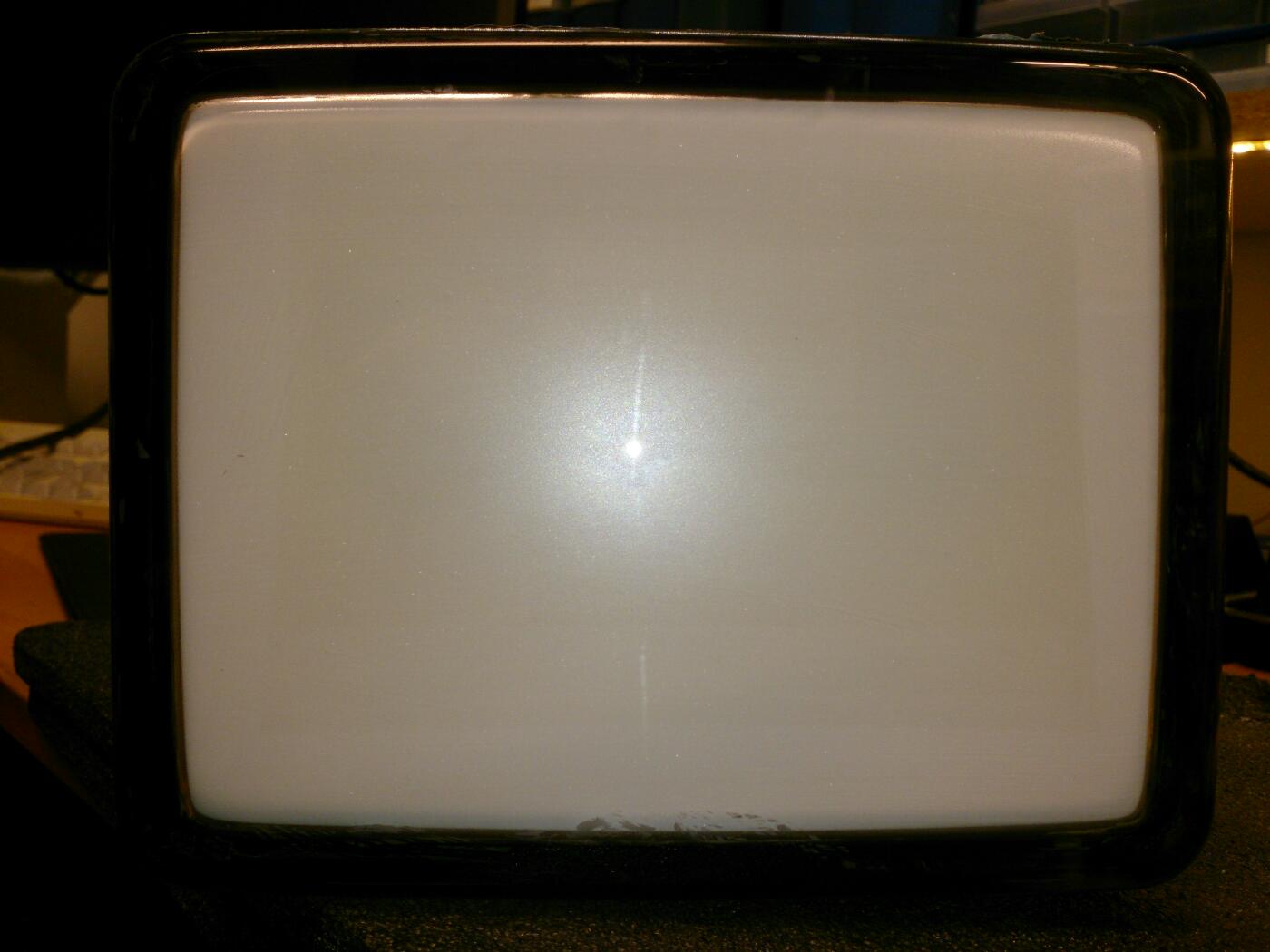

Posted: Mon Jan 27, 2014 3:03 pm    Post subject:
I was able to adjust the 808s mounting position to get much further to the edge than this, but perhaps it's within practical limits. The difference in available surface area between ideal and the 4:3 limit for this is about 44% (or 69 % area left).
Dedicating the 1209 for 16:9/2.35 use only does not help either since this helps maximizing the width with no round tube corners to worry about.
None here who successfully worn a tube into shape by using an inverted image? You all paid up instead?

Melifluonze wrote:
Posted: Mon Jan 27, 2014 3:09 pm    Post subject:
Just an FYI, the pix from the website above showing tube wear had significantly worn tubes, not the very light wear that you show in your tube pix.
Put the tubes in the set you're going to use them in, and max out the phosphor area to past the wear points. Set the projector up floor mounted first, and see if you can live with the slight wear. I have a feeling you can. If not, move the projector back so that you're within the wear area, and use it that way.
Unless you're putting 6-10 hours of use on the set per day, even running the set within the wear area should last you a good 5000-6000 hours (if not more, depending on your contrast setting), and chances are the set will fall apart before the tubes are toast.

Melifluonze wrote:
Posted: Mon Jan 27, 2014 4:31 pm    Post subject:
That's a very slight level of wear. I'm guess it will probably only be noticeable in fairly solid backgrounds like clear blue skies or when you're watching something like Ice Age with lots of light, solid backgrounds.
I wouldn't mess with wear-matching; you probably have at least as much of a chance of making the problem worse as you do fixing it.

My BG808s had about similar looking tube faces and that was unwatchable for me.
Nasty edges and white in worn area looked like IRE5. Thumbs Down
