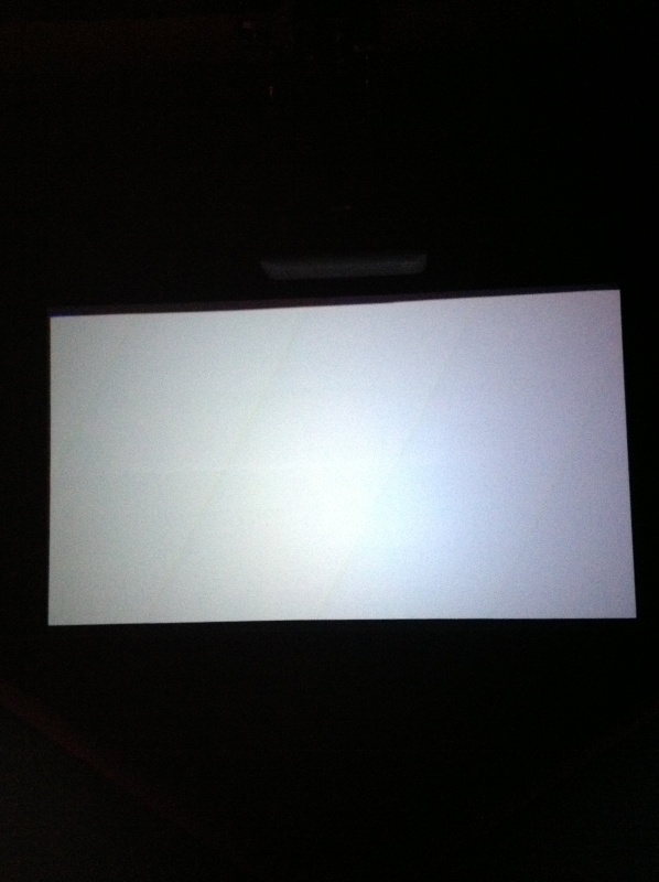

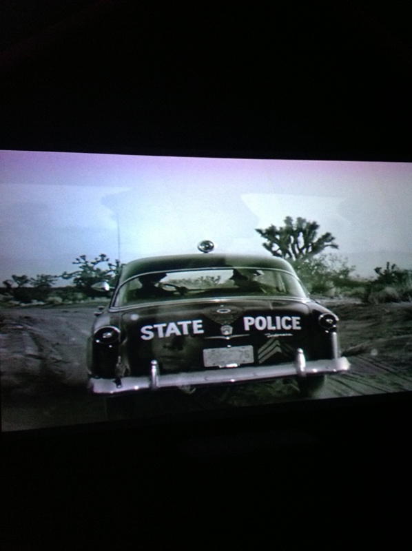

I sold this set about a year to 18 months ago, and the customer is complaining about a reddish line at the top of the pix, clearly shown below. Thing is, the all white field doesn't show it.
Signal path is BluRay player to Lumagen to Moome card in projector.
I also see some potential hazing of the glycol in the green tube according to the b/w image below, but that could be his camera. Am working with him to narrow that down.\
Now, here's the weird part that's throwing me off:
When he shrinks the image height, the reddish band moves with the image! that rules out tube issues (more or less, at least for the reddish band), and when he switches to cable, the problem remains. He also bypassed the Lumagen, and the problem is still there.
That pretty much leaves the HDMI cable (doubt it!), the RGB input board or the Moome card.

That bottom picture has all kinds of crap in it. A face, some sgt. stripes, other anomalies. Whats up with that?
Posted: Thu Jan 23, 2014 2:04 am    Post subject:
I see that. Having the customer check for anomalies, he's going to fire up one tube at a time. there are some floaties in the red tube glycol, but that doesn't explain any of what we're seeing on the screen.
Oh, the image is a freeze frame of a DVD, I'd expect a dissolve to explain the face. Smile

The all white is fine? Is it internal pattern?
Posted: Thu Jan 23, 2014 2:25 am    Post subject:
Yep.

Posted: Sun Jan 26, 2014 3:33 pm    Post subject:
The customer solved it, it was the VIM. Sadly, he didn't mention, nor did I remember that he had boards from his old 8500 that the 9500 Ultra replaced. He was talking to Mike and myself, and Mike suggested swapping the VIM, and all his issues went away.
BTW Mark, good suggestion, but if the glycol were low, the tinting would also be seen in the all white test pattern. that didn't show it, which led me to believe it was the VIM or the Moome card.
