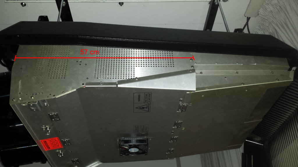

I got a pile of stuff in the mail today in order to convert my BG1209/2 to continous scheimpflug. First off, the chassis seem to differ. I was under the impression that I might have to make new holes and use nuts since there would be no press-nuts in the correct spots. If I line up the top piece which the housings are attached to to match the outer cover, the hinges will go several centimeter further to the front than they should. I can cut out a piece of sheet metal to extend it but there are other differences too like ventilation holes differ and the side plates are too short on mine for the top piece to be attached with both screws on each side.
This must have been done before. What is the correct procedure?
1209s-top plate on the left side.

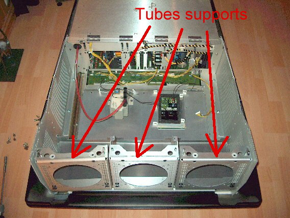

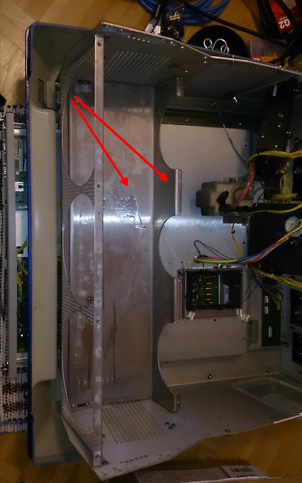

You must to use the 1209s top cover and the tube's supports that you see below.
 Filesize:  85.97 KB
 Viewed:  8662 Time(s)
Domenico (Barco fan!)

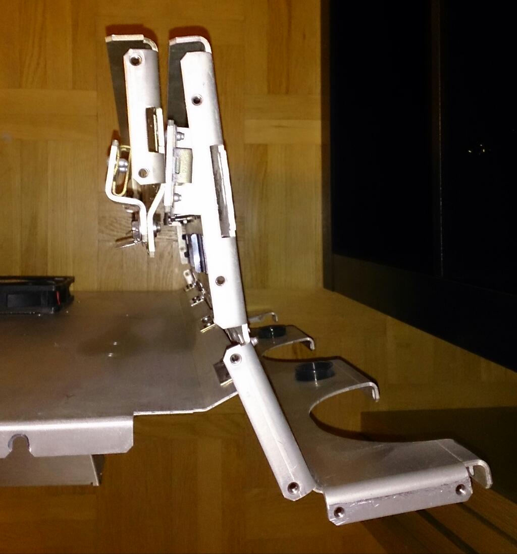

Posted: Sun Jan 12, 2014 1:31 pm    Post subject:

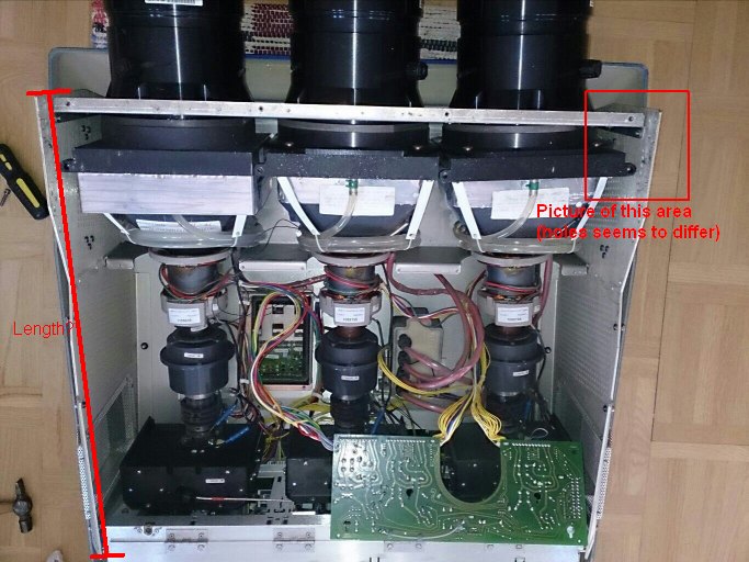

This L-bracket seems to differ. Do someone happen to have a photo of it at a different camera angle where the screw holes close to the front is visible?
Also, can someone measure the length of this part and/or close-up of the holes at the front?
What's the length of this part?
 Filesize:  90.54 KB
 Viewed:  8654 Time(s)

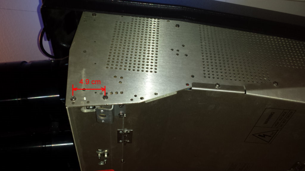

L-bracket differ.
 Filesize:  197.09 KB
Melifluonze wrote:

Decibel wrote:
I hope that this image can help you.
Sorry, not really since I already have this chassis. I need to find out the difference between 1209/se and the chassis in your picture. Can you take a photo of your equivalents to R805628 and
R805033 in your 1209s? Preferably with a ruler or tape measure for scale.

R365005 is different because in 1209s there are three pieces with holes for tube's fix, scheimpflug and others.
Look very well my previous picture.

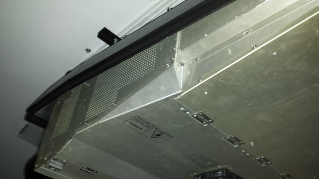

The picture that you asked
 Filesize:  75.04 KB
 Viewed:  8621 Time(s)

Posted: Sun Jan 12, 2014 6:15 pm    Post subject:
Other picture
 Filesize:  71.58 KB
 Viewed:  8617 Time(s)

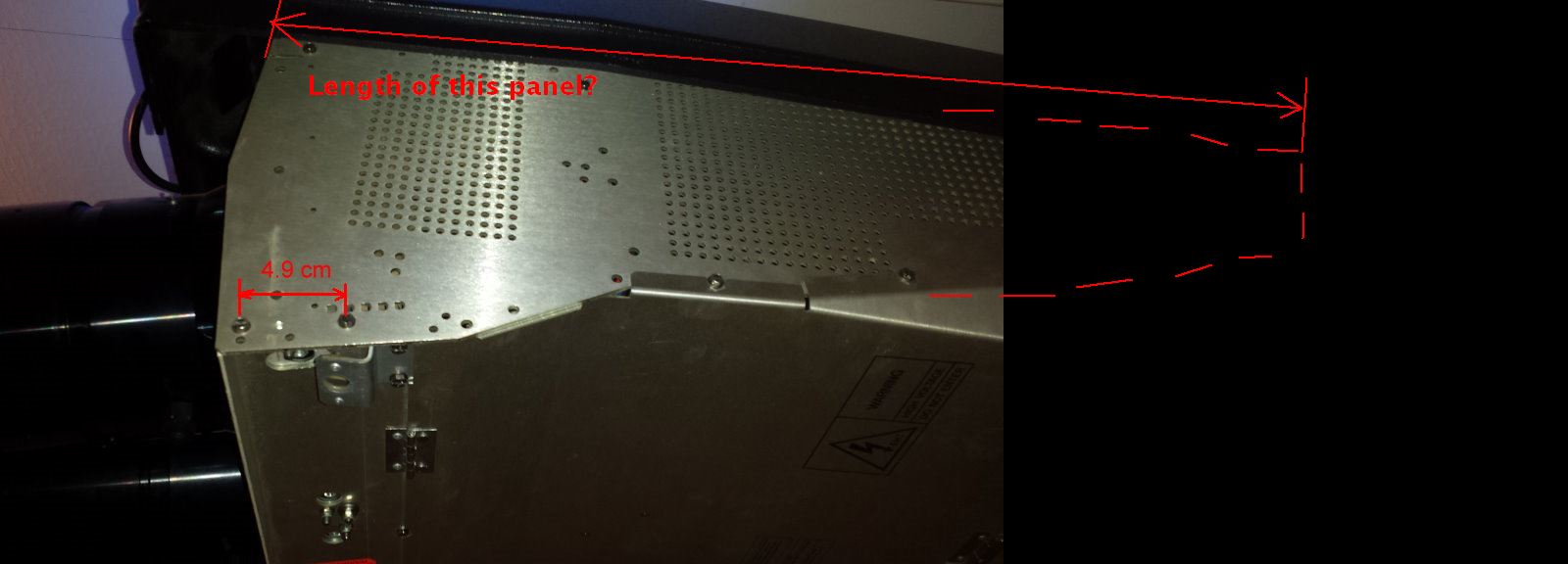

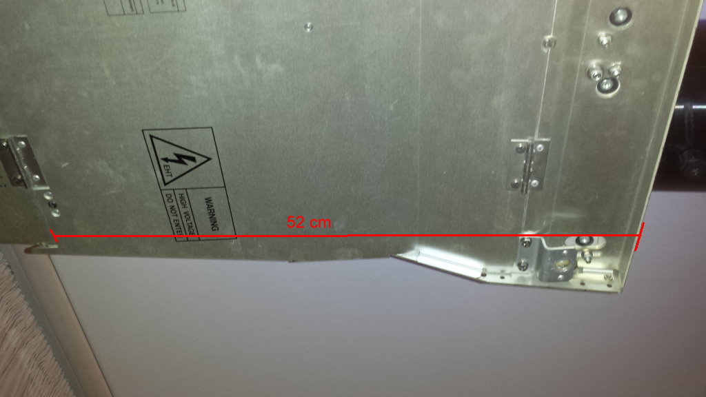

I know. I mean the equivalent panel in your 1209s to the R805033 in 1209.
I used your picture and extended it to show what I mean.
To change the parts in question, how much do I need to strip down? Flip the projector over, take off the outer casing, then what?
Also, someone suggested me to change out some capacitors on the motherboard while I'm at it because they fail over time and are difficult to change unless the projector is in parts. Which capacitors would this be?
What is the length of this panel?
 Filesize:  67.66 KB
 Viewed:  8607 Time(s)

Posted: Mon Jan 13, 2014 1:36 pm    Post subject:
Here
 Filesize:  90.81 KB
 Viewed:  8582 Time(s)
 Filesize:  77.31 KB

Posted: Mon Jan 13, 2014 4:42 pm    Post subject:
The panel is different?

I measured the length to be 565 mm, which should be within margin to match your measurement. The holes does however differ. Thank you very much for your picture!
Since I need the bottom plate and top cover and pay for shipping for them, I might just as well get the side plates as well instead of drilling.

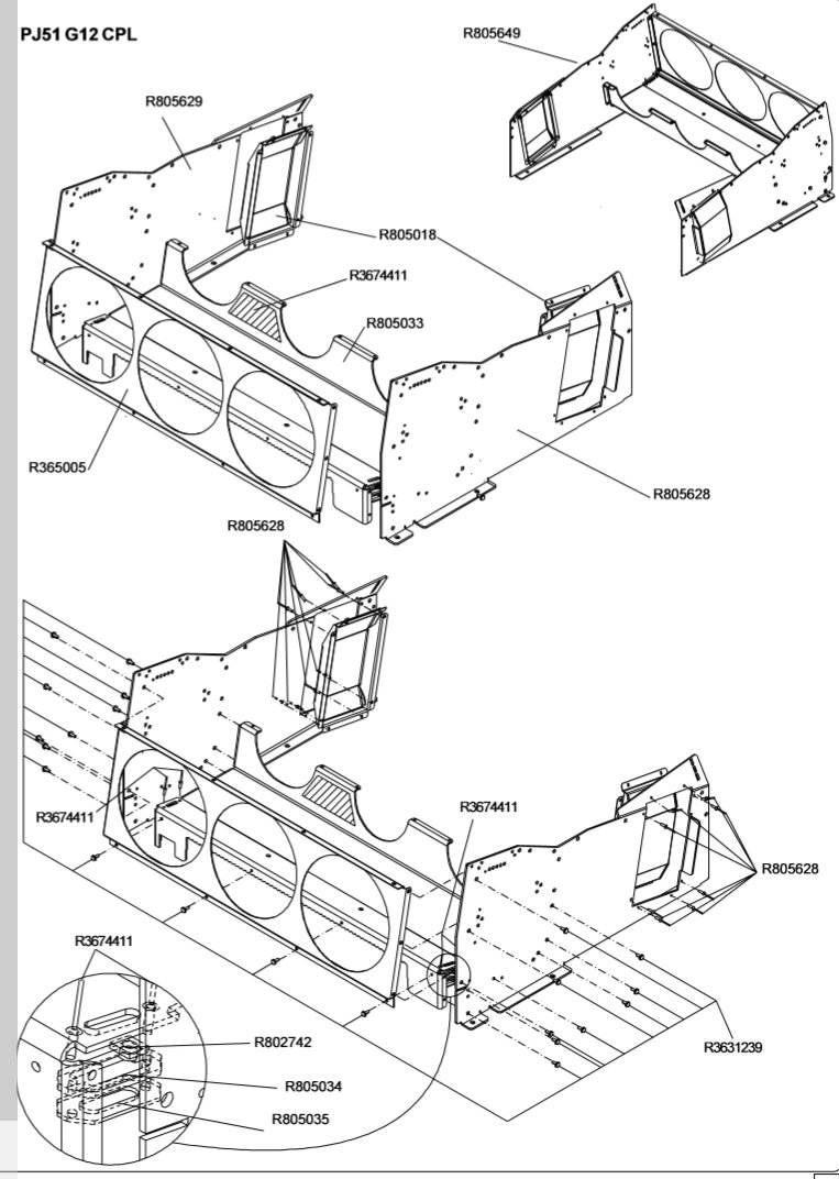

Does anyone have the exploded view of the 1209s chassis for reference? I have the service manual but no chassis in it.
In the service manual of 1209s there is the exploded view of the older chassis Rolling Eyes
