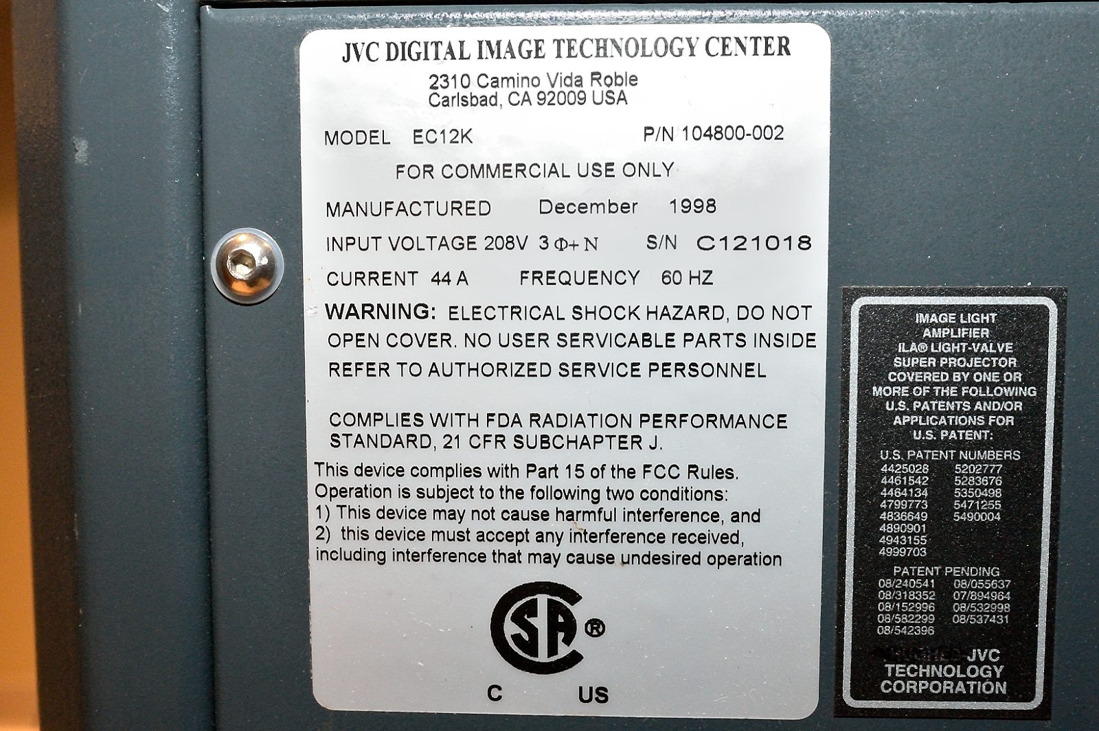

The EC12 was just the last run of the 12k projectors that Hughes-JVC made, for Electronic Cinema (EC - get it?) use. Your unit should have the latest modifications in it. I literally just decommissioned a 12K projector a week ago and have two lamps for it, the complete manual, etc. that you are welcome to. The "Guru" on these is Leo Bassett at Electronic Cinema Service. He has one running at his house.
Be aware that this projector needs 50 amp, 208 volt THREE PHASE power!
Look Familiar???
