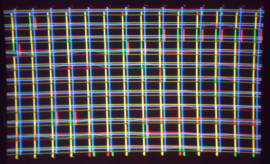

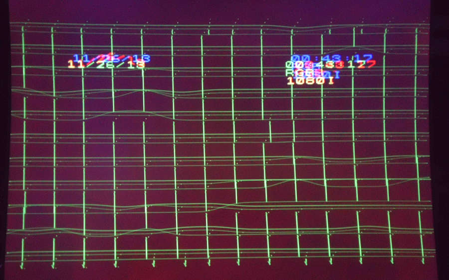

The point convergence board on my 9PG has developed an odd intermittent problem. It seems fine when cold, but after about an hour if the projector has to re-sync, it loads completely wrong values for the red and green point convergence. Attempting to adjust any point results in the entire screen changing wildly (although not randomly). Strangely, the blue is completely unaffected. Turning off point convergence restores a normal picture. I turned point on the next day, and it was fine until I changed sources after it had been on for an hour.
I suspect that there is a problem reading data from the EEPROM (maybe a bad address line that only affects the memory used for the red and green). That would explain why it works until it has to reload the point data.
I've already inspected the board for obvious problems (it has been recapped). I'm going to take one more look at it, but considering how hard it is to troubleshoot an intermittent problem on a very inaccessible board, I'd take a replacement if I could find one. Does anyone in the US have a board they could sell for a reasonable price? It doesn't have to be recapped.
Andy

Re seating the connectors hasn't changed anything. I still plan to try a few basic things on the my board, but I don't want to spend days working on a board if I can replace it cheaply. While I'm in there, I wouldn't mind adding the composite video board if anyone has one.
I don't want to get into a debate about whether or not the point convergence feature is a good thing. I'm fairly sure it's not supposed to make the whole screen look crazy at random times. Even if I don't use it, I wold like to have a fully working 9PG (including the apparently controversial point convergence board)...

We have a similarly bad point convergence board here too. And we found that the EPROM content on the bad board is corrupted.. I know of a good working point board so we'll try to rewrite the EPROM with the good working on, and we'll see if that solves the problem.
