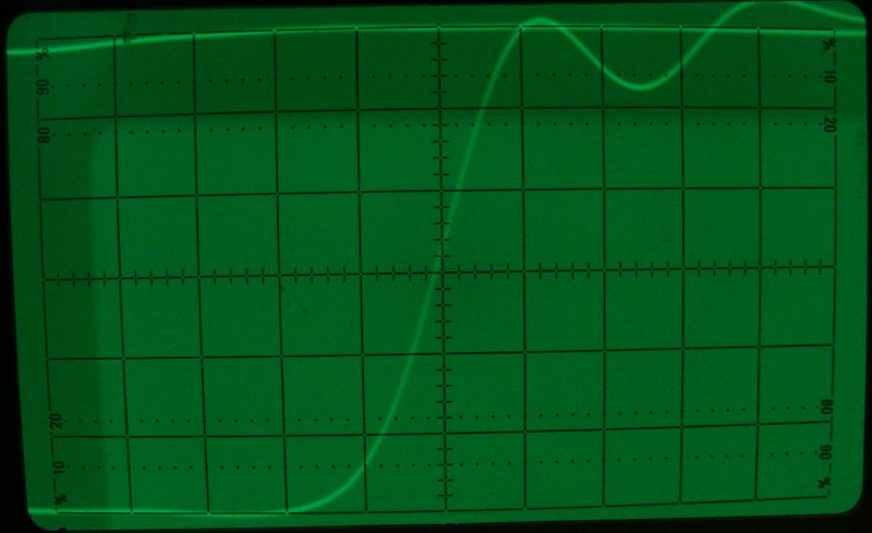

Asus nVidia GeForce 7950GT 512MB (PCIe):
Measured in 800x600 with a specially breed test pattern (to ease scope triggering) otherwise this is a simple multiburst, bandwidth pattern.
There was a slight overshoot, I set the 100% level to where the signal settled,
Total measured rise time(10%-90%): slightly less than 1,6ns
solving the equation gives us: 0,93ns calculated rise time for this card which would mean a bandwidth of about 375MHz, where the advertised bandwidth is 400MHz.
nVidia GeForce 7950GT rise time on a HP1720A o'scope

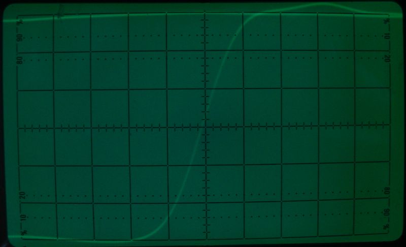

integrated intel GMA950 (i945GZ on a foxconn motherboard):
Measured in 1920x1080 96Hz with the same pattern as above
Total measured rise time: 2,4ns
Calculated rise time for this VGA: 1,77ns -> ~200MHz, this is about the half of the advertised 400MHz.
That's it for now, an ATI HD3650, and other nVidia cards will follow soon.

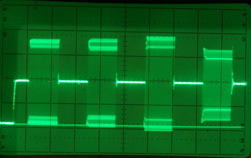

pattern

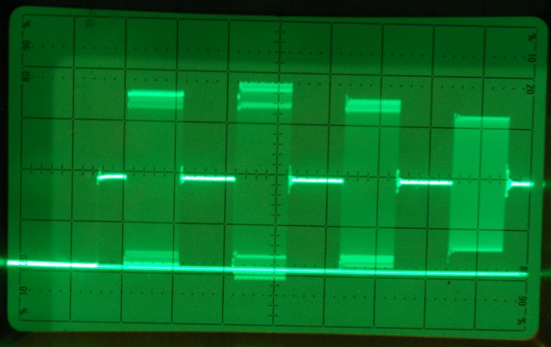

Posted: Wed Dec 04, 2013 12:29 pm    Post subject:

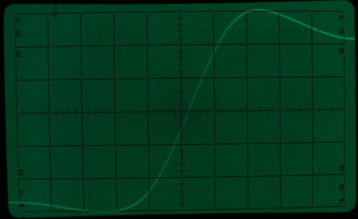

Reference (Sapphire) ATI Radeon HD4650 (PCIe):
Measured at 640x480
Measured rise time: 1,8ns
Calculated rise time for VGA: 1,2ns -> ~280MHz (claimed bw: 400MHz)
 Filesize:  35.45 KB
 Viewed:  25063 Time(s)

Posted: Fri Dec 13, 2013 10:01 pm    Post subject:

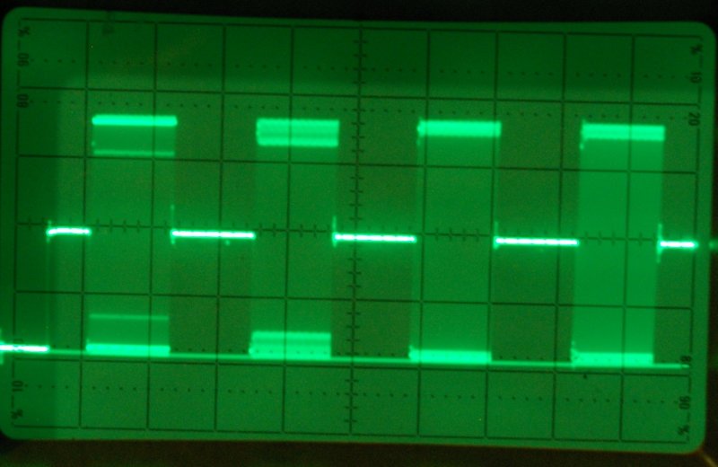

ASUS GeForce 8800GTS 320Mb (G80 core, PCIe):
Measured at 800x600
Measured rise time: ~1,7ns
Calculated rise time for VGA: 1,1ns -> ~320MHz (claimed bw: 400MHz) But note the output is very similar to the GF7950GT's only with less overshoot, thus the slightly worse rise time.
 Filesize:  47.42 KB
 Viewed:  24970 Time(s)

Posted: Sun Feb 21, 2016 7:20 pm    Post subject:

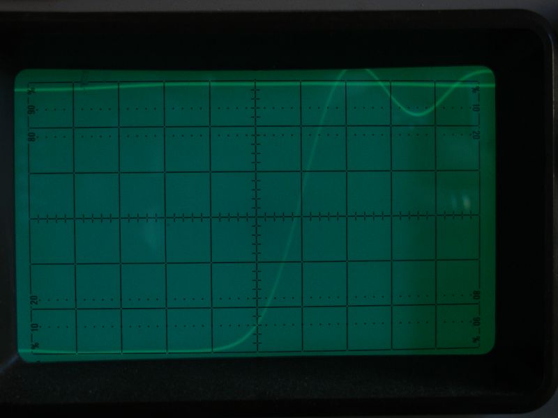

A new approach, multiburst signal.
Just because I was at it...
nVidia Geforce 6600GT
2048x1536 60Hz
 Filesize:  103.55 KB
 Viewed:  22380 Time(s)
1080p 72Hz
 Filesize:  106.19 KB
1080P 60Hz
 Filesize:  103.25 KB
