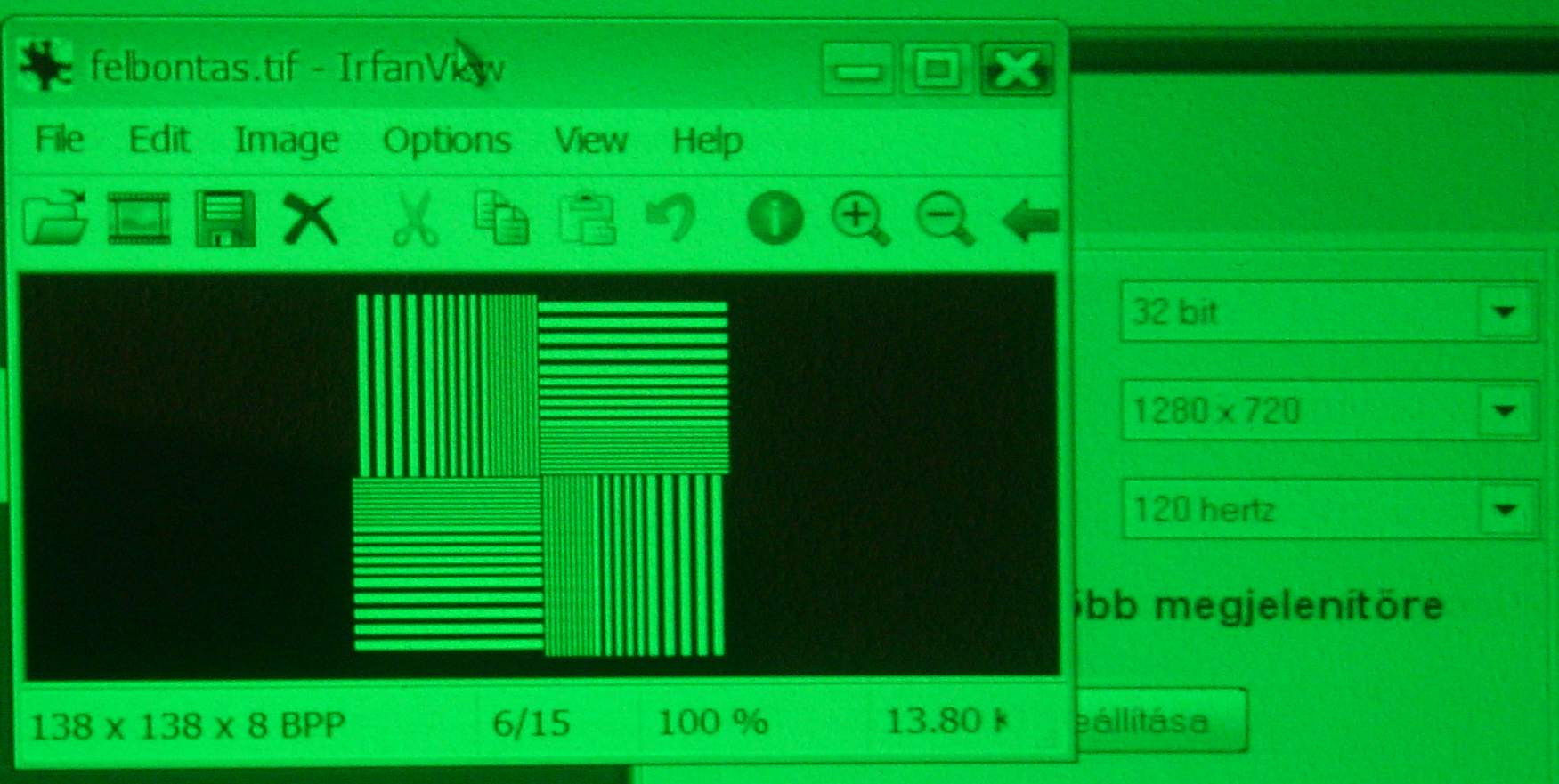

I show you how my NEC (marketed bandwidth is 100MHz) have done 720P-120Hz.
720P-120Hz

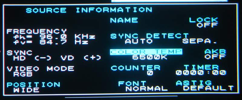

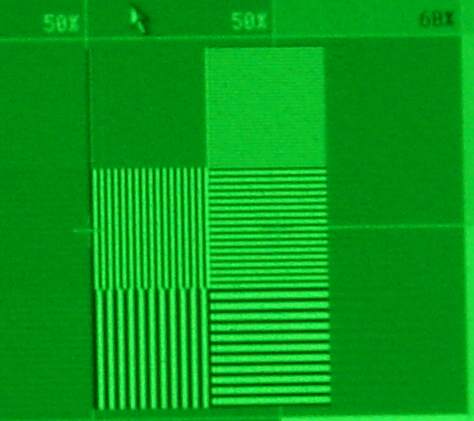

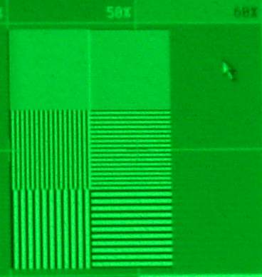

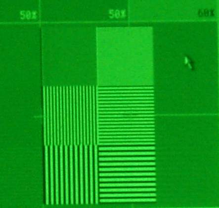

I understand you, but on a NEC it's a bit hard to take fun pictures like this because if you send a new signal to it, it will load the convergence data from a default area, and in my case it loads a sh!t color balance with sh!t convergence Smile
pictures are actual 1:1 cutouts (except info page)
fh=96kHz on a NEC PG xtra !!! OOOhhh the deflection board is just blowing up! :D

1080P-85Hz
 Filesize:  28.67 KB
 Viewed:  11734 Time(s)
1080P-75Hz
 Filesize:  27.79 KB
 Viewed:  11735 Time(s)
1080P-60Hz
 Filesize:  24.1 KB
 Viewed:  11737 Time(s)
