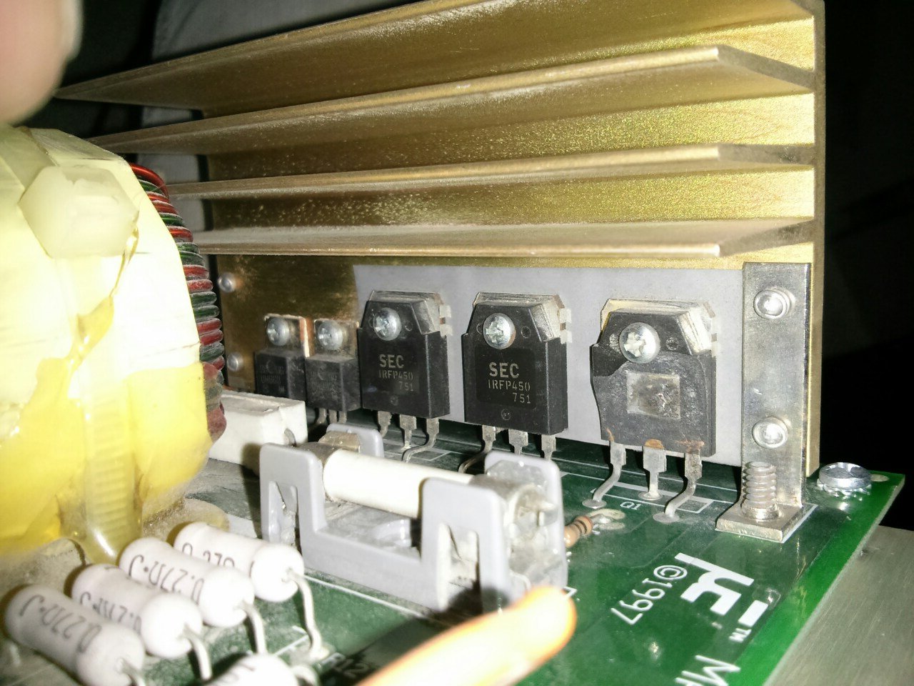

Right, LVPSU out, opened and dusted (it had 14 years of dust in it, looks like the projector was made in 1999 from all the date stamps, although some on the chassis say 1994).
I heard a rattling sound on removing the LVPSU and have found half a power transistor floating around, might be all/part of the cause. See photo attached.
Is it worth me simply replacing it and testing it again?
LVPSU with blown transistor.
 Filesize:  226.33 KB
 Viewed:  8320 Time(s)
Richard
Posted: Sun Dec 01, 2013 3:09 pm    Post subject:
Try that, but it most likely has other issues in it. If you need another LVPS or PC board out of it, let me know.

I'm hoping this part will be suitable.
