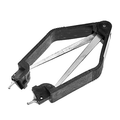

Thank you Thanasi! I will definitely get it. I will ask a tech to come over for the first time I will remove chips and clean contacts, so that he can show me the safe way to do it. Can you recommend a proper tool for removing the chips from the board?

Hello
You will need a PLCC chip puller, usually found on Ebay for $5-6
This type is the best. you squeeze the arms together and it pulls the chip up.
