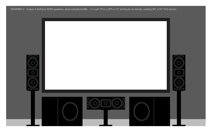

My screen wall is just 13-feet wide x 7'-10" high. The current screen is 96x54 110 diag, ~1.3-gain Wilsonart DW. Here's about what the room looks like currently, save for the fact that the subs are much larger now:
It's a little hard to see. Here's an illustration:
Those little M&K's look absolutely puny these days!

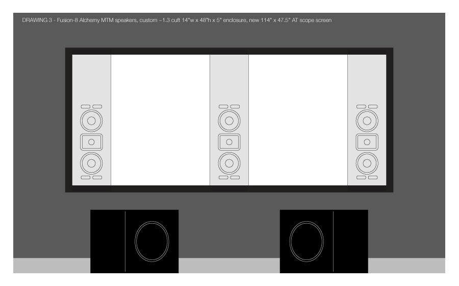

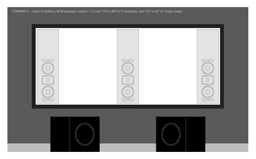

That doesn't get me where I want to be screen wise though, so I'm looking at two other options:
9.5-foot wide scope screen
10-foot wide scope screen
To go scope, I'll need to make very large baffles, but very shallow cabinets, and they'll need to recess into the wall cavity. Besides being able to go scope, I can nearly eliminate boundary effect, and clean up my screen wall, lock dialog into the screen, and have a more uniform sound field for all the seats. With the shorter screen, I also get better site lines for the back row, and of course the scope image is larger then the 1.78 image - as it should be.
