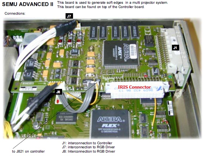

Posted: Thu Oct 24, 2013 1:58 pm    Post subject:
If You have the SEMU Board, then it goes first and the IRIS Board goes onto the SEMU Board in a 90 Degree angle...

Posted: Thu Oct 24, 2013 3:13 pm    Post subject:
No, I don't have that one, that is the one I thought was in there that I was going to remove Wink
Posted: Thu Oct 24, 2013 3:47 pm    Post subject:
Oh, and the reason it's not in there is because you have a Cine (Home Theater) series Barco. The SEMU is in the Simulation version of the Barco (909) and not necessarily in all 909's.
Not having it in there is a good thing. And even if you did and wanted to use it for blending, it is the worst blend system on the planet. Tons and tons of odd-ball adjustments in the menus, as if it was designed by a bunch engineers on crack.
