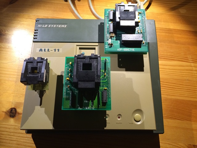

Therefore I've invested into some technology: A professional Reader/Programmer for PROMS, EPROMs, FPGAs and OTP Controllers (OTP = One Time Programmable) together with the required programming adapters for the essential components that hold the Marquee's firmware (see Picture 1).

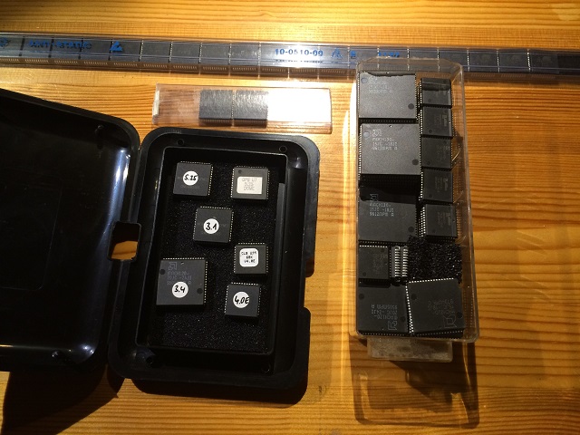

Then I sourced blank and rewritable chips and used them for the creation of two identical sets of CLM/DPB boards with the newest firmware available to me (see Picture 2 and firmware list).
Well ... it works!
So I can say that I'm able to read and write all relevant parts needed for a specific firmware version.

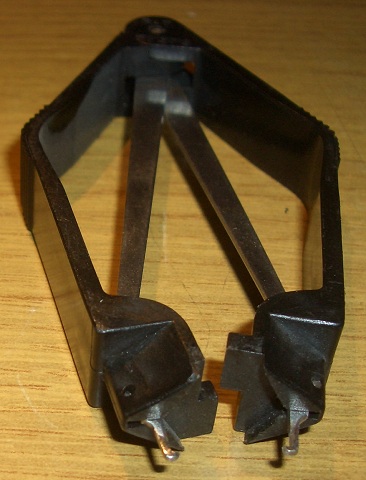

I will have to think about a secure and efficient method of transporting single chips and/or boards for interchanging this kind of stuff.
Not everyone has a chip puller (see picture) and will be comfortable with shipping his working CLM and/or removed chips.

I have a puller just like that, if i can find it.. Embarassed
And your right,, I would not dare put them all in one bag, and ship them, emagine if they all got lost..
