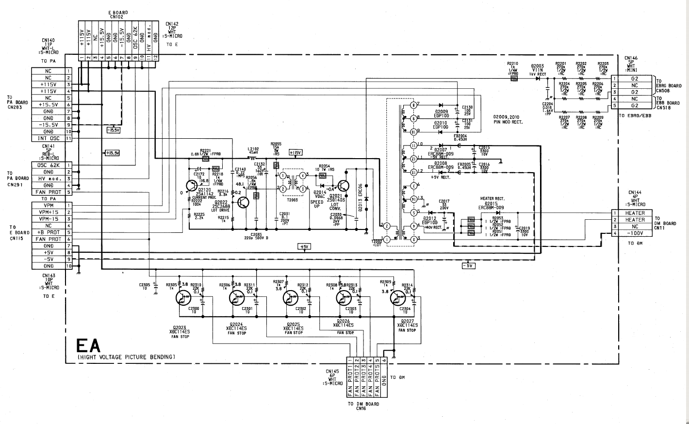

Is this a problem on EA give the same error code ? I have a doubt on this card, as there a few months ago , glycol sank it. ( leak on the red CRT)
Another board can generate a code 02

Glycol flowed across the power supply output by the fans.
But it worked perfectly for the repairs.
I test this we 115V on the EA board, and if I have it re-opens the power supply.

I tested the EA Board yesterday. All voltages are there.
The 115V comes well on E Board. In the instructions , it says that the IC115 is the detection of 115V.
This may be causing him problems or the signal after this component.
Is there a way to temporarily bypass this error?
