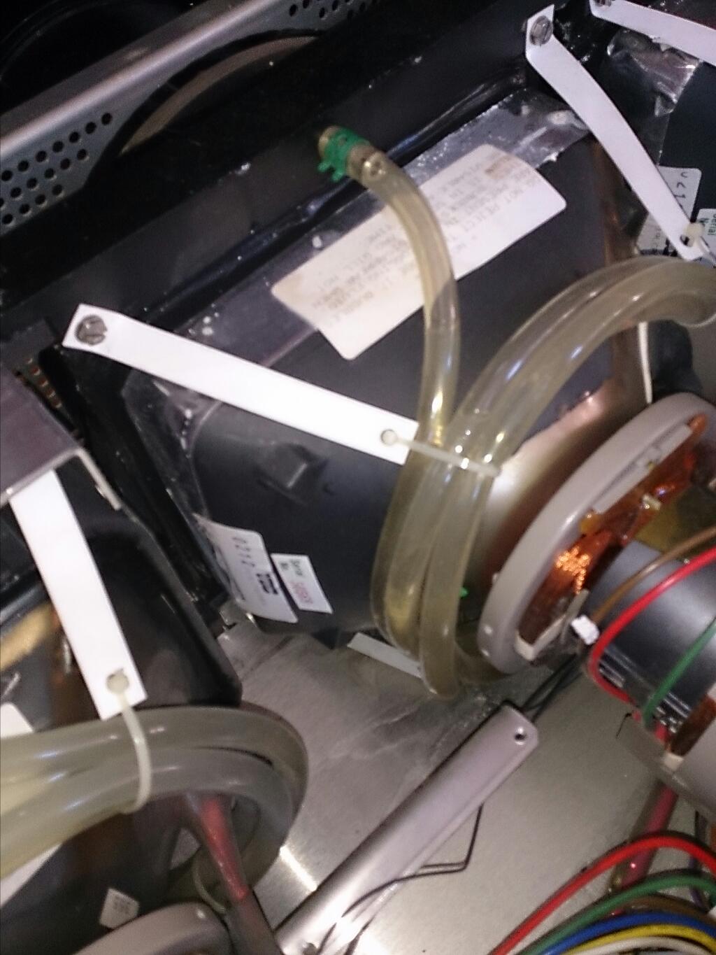

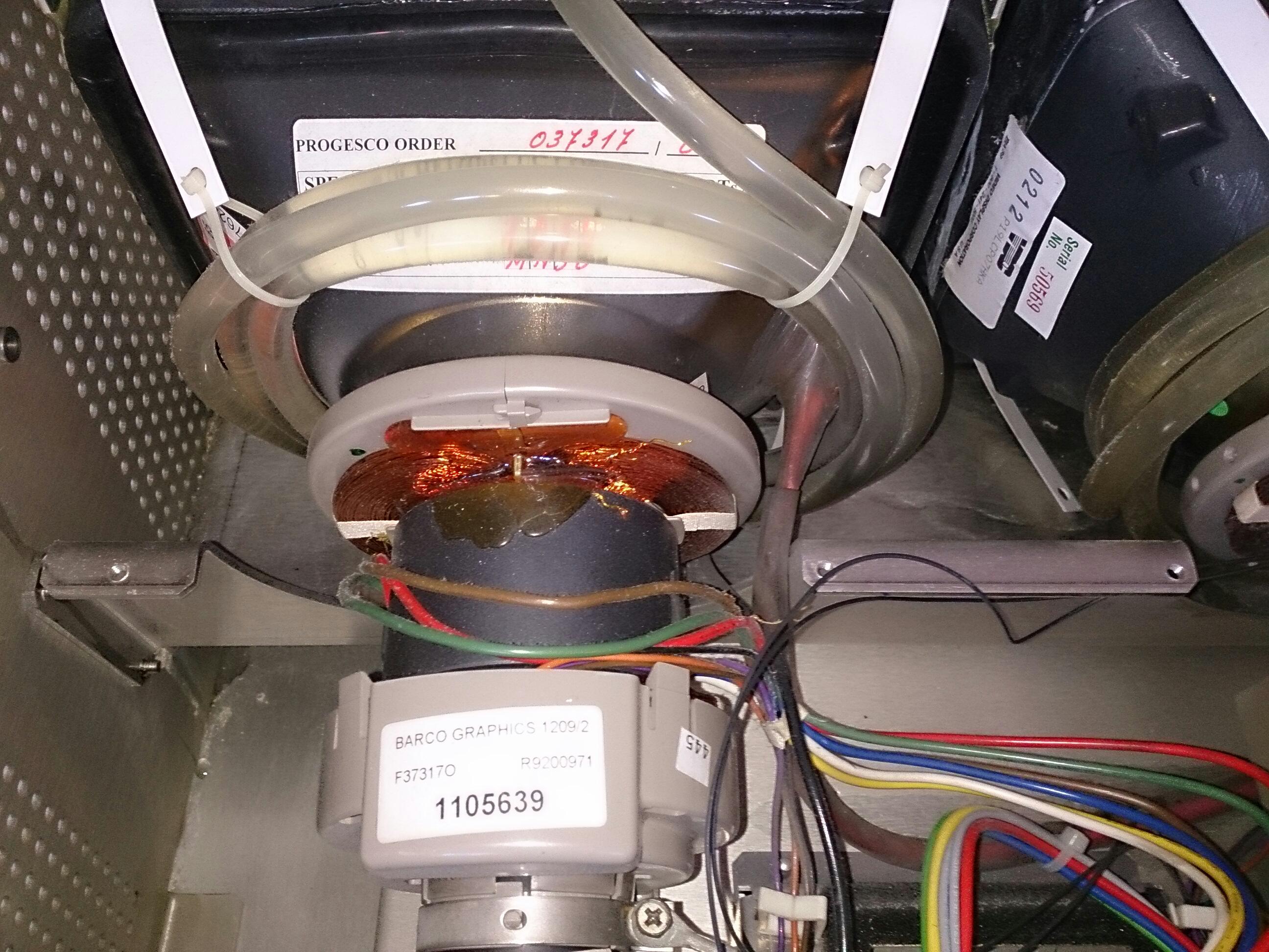

Bought a Barco 1209/2 which had two known problems, no red output and glycol leak. Apart from that it was running fine and I watched it in operation before we took it down from the seller and packed it up for the long journey home.
I opened it up yesterday and found a lot of glycol inside. Messy stuff but the PCBs seem to have been spared from it. From what I could tell, there was no glycol inside the tube of the red tube, but it was very hazy so difficult to tell. The blue and green was filled almost all the way on the other hand. I apologize for the focus. Sony telephone = very high resolution camera wasted by useless focus. Thumbs Down
As a total CRT newbie, I need to ask some dumb questions.
1. Does glycol leak cause immediate tube failure at turn on? The red tube was working six months earlier but the seller said he hadn't used it much/at all since. He just powered it up to take a picture of the (lack of) ware for me. Could it have started to leak over time and when he turned it on again before the sell it failed?
I was under the impression that the glycol's main function was to act optical medium to stop haloing. With about 550 W input to the projector and lots of losses on the way, I don't see more than 150 W hitting the tube face and several kg of glass to absorb the heat so even if the glycol is there for cooling, the peak temperature would not rise that quick.
2. If glycol leak over time, wouldn't this be visible as picture distortion?
3. What else could cause the red channel to stop functioning? Is there a way to troubleshoot? Any on-board diagnostics?
4. I read about colored glycol to improve the color rendering and this is highly appealing to me. As a light-nut, I usually try to play "guess the light source" with my friends which includes discriminating pink skin tones being rendered slightly different under different batches of LEDs, or telling metal-halide from fluorescent and telling 2700K from 3000K by no other aids than just built in "absolute pitch". This will quickly reduce the number of people who want to hang out with you if anyone is interested to reduce their social circle Wink. If I need to fix a new tube and refill the glycol, can it be retrofired with colored glycol?
5. Suppose the red tube is broken, what can it be replaced with? What options do I have if the neck boards are modified (looks easy to do)?
Glycol visible mainly on the green and blue tube, although found all over the front compartment in general.

Green tube close up. Sorry about the focus. Glycol in place.

Red tube close-up.

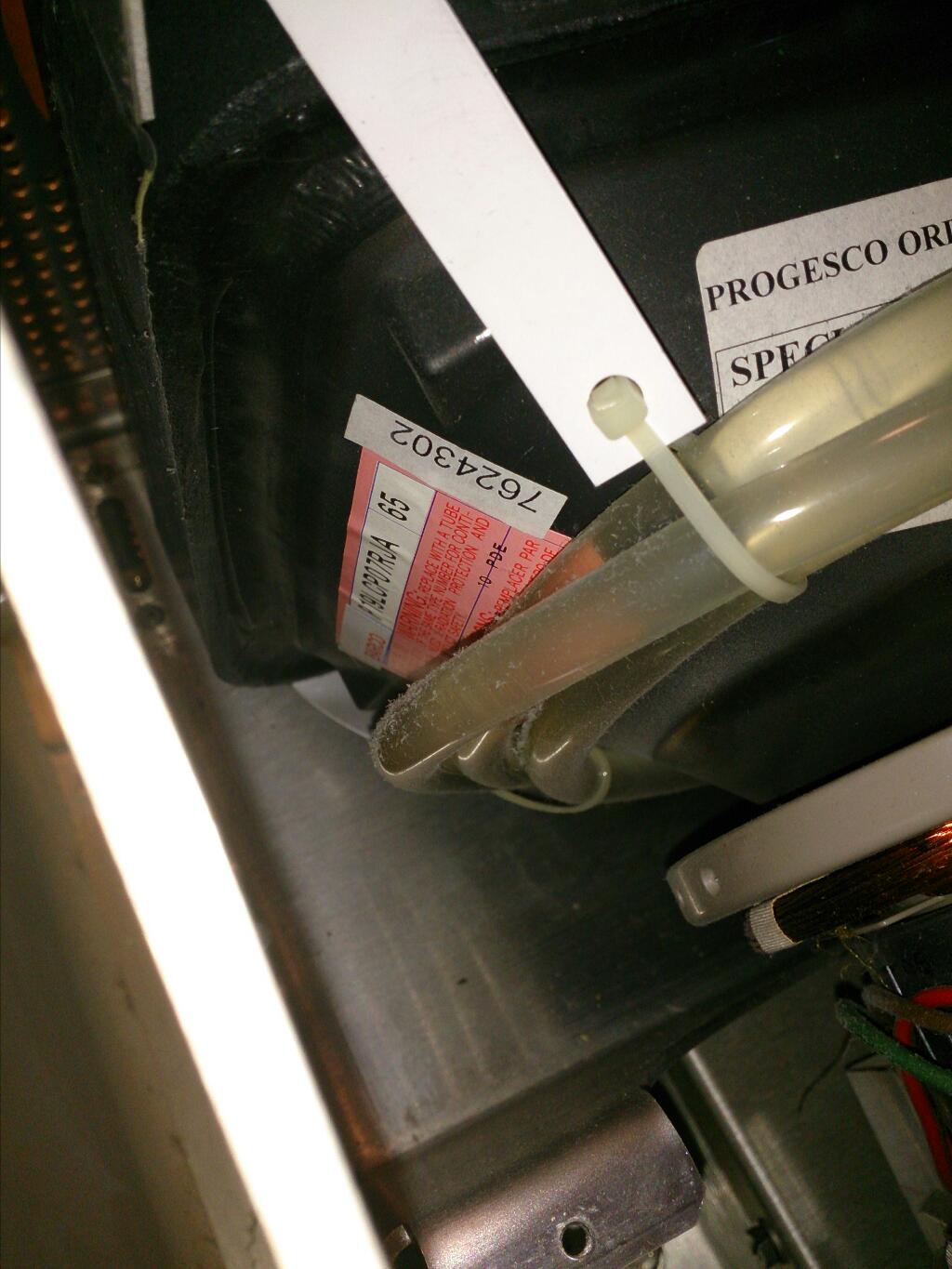

Glycol on front-most steel sheet.

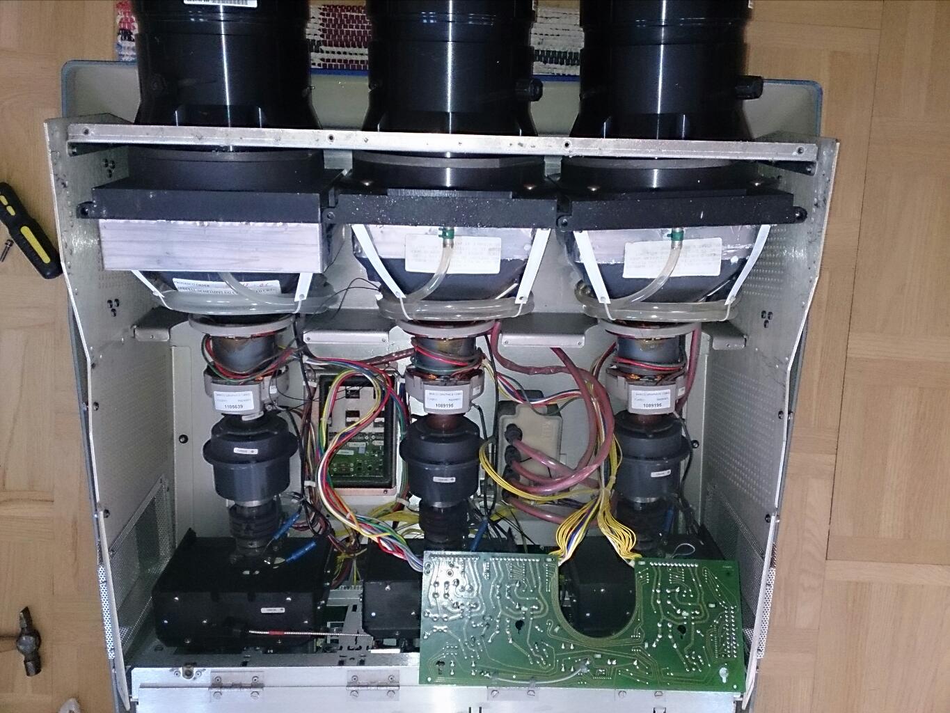

First of all remove the convergence tray (loosen two screws show in my photo an pull the tray) and check if glycol has go in this tray.

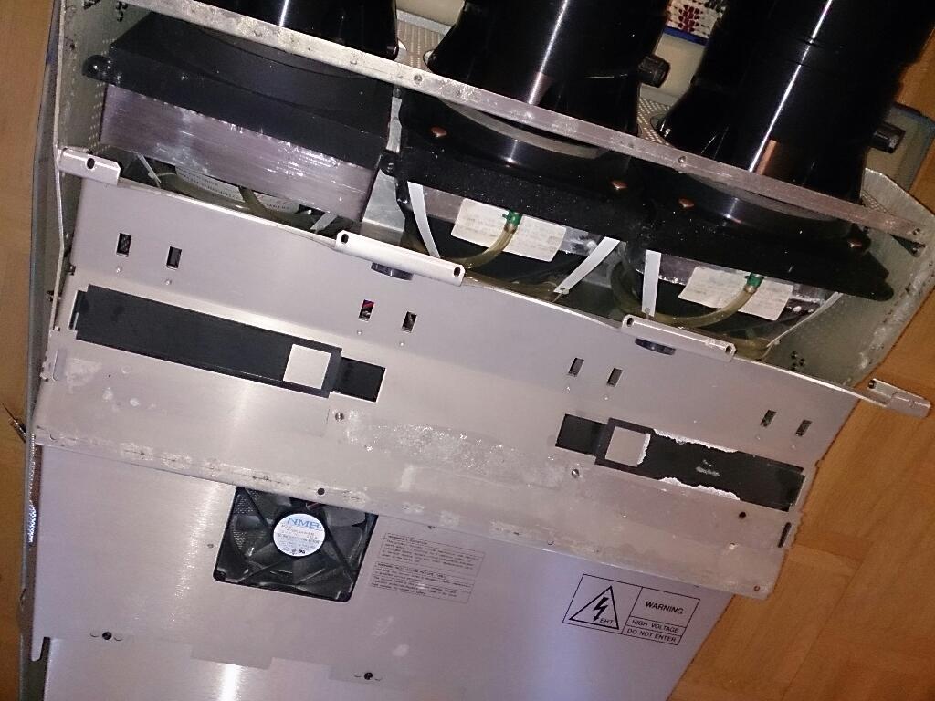

Posted: Mon Oct 14, 2013 9:22 pm    Post subject:
Yes indeed! I hope it will wash out of my clothes and won't stain the wooden floor. I'll wash the pcb in isopropanol at work tomorrow.
Any tips for loosening a stubborn lens that won't come off?
I did not realize how modular the projector is until now. Also, what a nightmare to build it! Patches everywhere and odd heatsinks all over the place. The did however do two sided SMD, which would be pretty exotic outside the mobile phone industry.

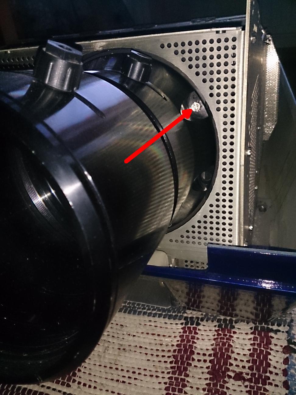

In that case, no. Can you show with a picture?
Melifluonze wrote:
Decibel
Joined: 31 May 2007
Posts: 904
Location: Roma - Italia
Posted: Mon Oct 14, 2013 10:34 pm    Post subject:
But I have another projector. Similar but not identical.
So you should be the one to take a picture and show it to have some help.
However, this below is a photo of a 1209. The red circles show the attachment points of the lenses.
Unfortunately I don't have a pictures of this projector with lenses.
Domenico (Barco fan!)
winny
Joined: 09 Oct 2013
Posts: 403
Posted: Tue Oct 15, 2013 7:01 am    Post subject:
Four of these where loosened. Is the next step to pry and break the lens and the tube apart?
Also, can I test swapping over the drive from say the green tube first? If I take everything apart and reseal the red tube only to find that the tube is broken, it will be a lot of work for nothing. Can the tube be tested without glycol or not?

Posted: Tue Oct 15, 2013 9:48 am    Post subject:
Perhaps I do not understand due my different language, sorry Neutral Crying or Very sad
You must REMOVE the four screws for each lense.
The lenses are very heavy and will drop it in your hands, be careful.
I never start tubes without glycol, I do not know what could happen.
Maybe at your own risk you can do it for a few seconds and check if it work.
Decibel
Joined: 31 May 2007
Posts: 904
Posted: Tue Oct 15, 2013 9:50 am    Post subject:
The screw that show in your picture, perhaps fix the tube, not lense.
winny
Joined: 09 Oct 2013
Posts: 403
Posted: Tue Oct 15, 2013 10:20 am    Post subject:
Yes I did that. Still the lens wouldn't come loose.
The positions of the screws are a little bit different in mine than from the pictures of your projector though.
